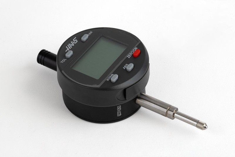

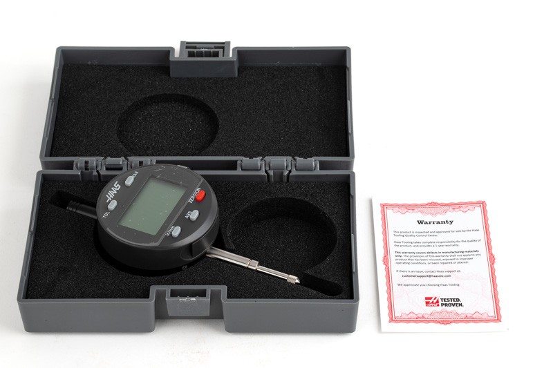

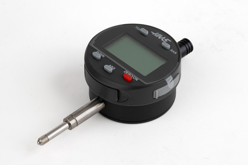

This high-precision Haas digital drop indicator has a measuring range of 0.5" (12.7mm) with a resolution of 0.00005" in inch mode and 0.001mm in metric mode. Tolerance mode enables GO/NO-GO usage for inspection work. Zero may be set at any position, and absolute mode retains zero position after power-off. Comes with flat back plate. CR2032 battery included. Comes with certificate of calibration.

Type Digital Drop Indicator
Gauge Type Digital
Mount Type Stem
Indicator Type Plunger
Dial Diameter 57.4 mm
Range 0-0.5 in \ 0-12.7 mm
Stem Diameter 8.0 mm
Plunger Length 15.7 mm
Plunger Point Thread M2.5x0.45
Plunger Point Diameter 3.0 mm
Resolution 0.00005 in \ 0.001 mm
Accuracy ± 0.004 mm
Hysteresis 0.002 mm
Max Measuring Force 2.0 N
Standard JJG34-2022
Conformance Standard CNAS
Weight 0.7 lbs \ 0.3 kg
Calibration Certificate (Y/N) Y
Includes Battery Y
Power Supply CR2032
