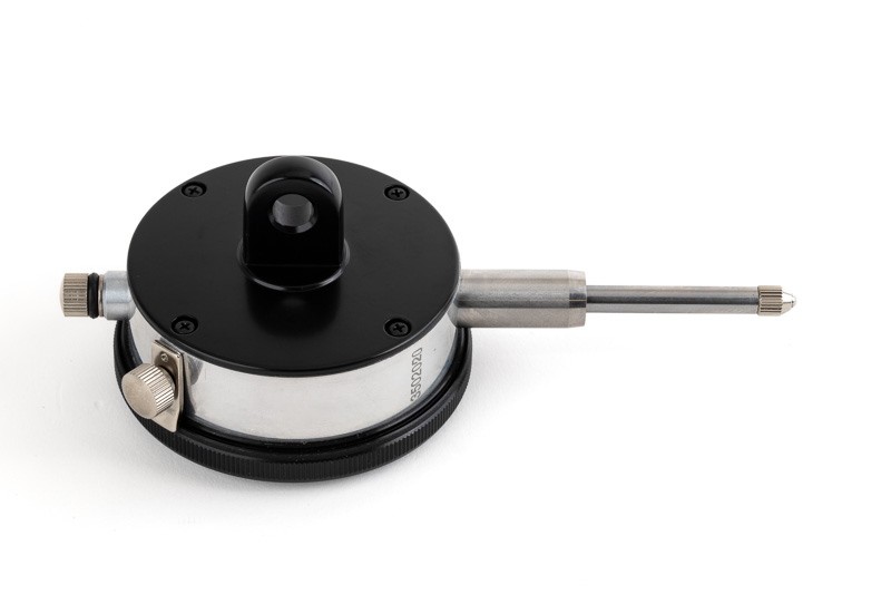

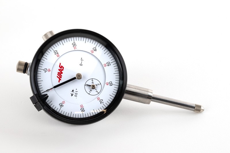

This Haas dial drop indicator has a measuring range of 1" with 0.001" graduations and numbering from 0-100. Bidirectional continuous numbering allows easy reading in both positive and negative directions. Comes with both a flat back plate and a lug back plate for more mounting versatility.
Type Dial Drop Indicator
Gauge Type Dial
Mount Type Lug Back, Stem
Indicator Type Plunger
Dial Reading 0-100
Secondary Dial Reading 0-1
Dial Diameter 2.28 in
Dial Type Continuous
Range 0 - 1.0 in
Range Per Revolution 0.1 in
Bearing Type Non-Jeweled
Stem Diameter 0.375 in
Lug Diameter 0.25 in
Plunger Length 1.38 in
Plunger Point Thread #4-48
Plunger Point Diameter 0.098 in
Graduation 0.001 in
Accuracy ± 0.001 in
Hysteresis 0.00033 in
Max Measuring Force 2.5 N
Conformance Standard CNAS
Weight 0.8 lbs \ 0.4 kg
