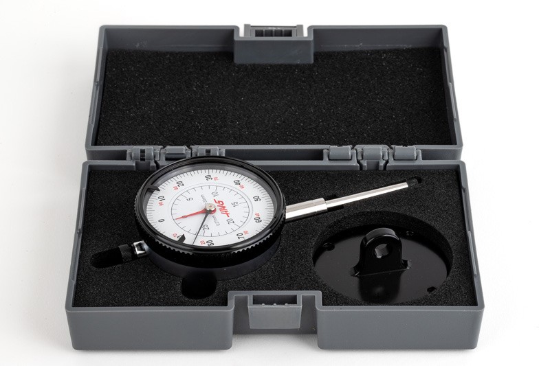

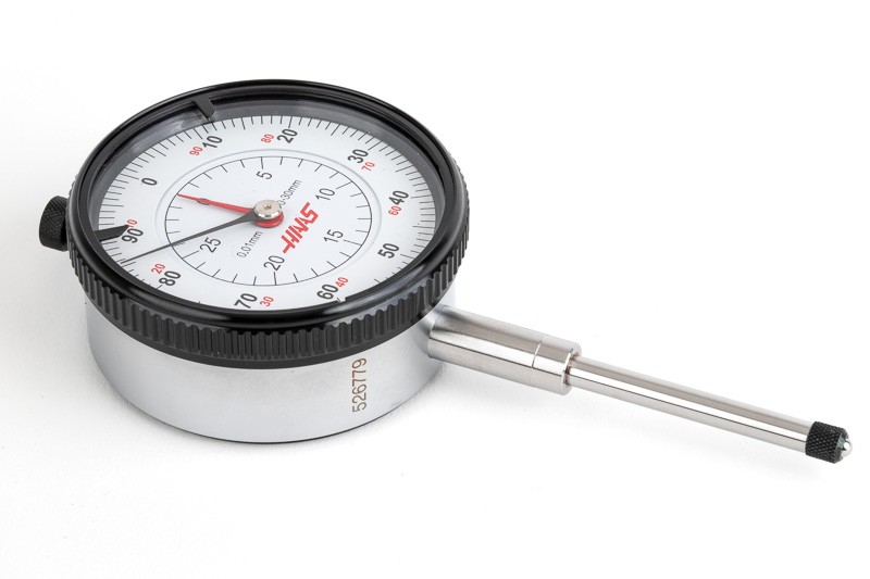

This Haas dial drop indicator has a measuring range of 30 mm with 0.01 mm graduations and numbering from 0-100. Bidirectional continuous numbering allows easy reading in both positive and negative directions. Comes with both a flat back plate and a lug back plate for more mounting versatility.
$37.97 (Save 5%)
Type Dial Drop Indicator
Gauge Type Dial
Mount Type Lug Back, Stem
Indicator Type Plunger
Dial Reading 0-100
Secondary Dial Reading 0-30
Dial Diameter 58.0 mm
Dial Type Continuous
Range 0 - 30.0 mm
Range Per Revolution 1.0 mm
Bearing Type Non-Jeweled
Stem Diameter 8.0 mm
Lug Diameter 6.5 mm
Plunger Length 40.9 mm
Plunger Point Thread M2.5x0.45
Plunger Point Diameter 3.0 mm
Graduation 0.01 mm
Accuracy ± 0.035 mm
Hysteresis 0.007 mm
Max Measuring Force 2.2 N
Standard JJG-379-2009
Conformance Standard CNAS
Weight 0.9 lbs \ 0.4 kg
Calibration Certificate (Y/N) Y
