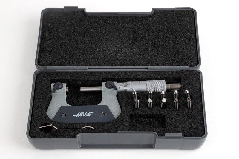

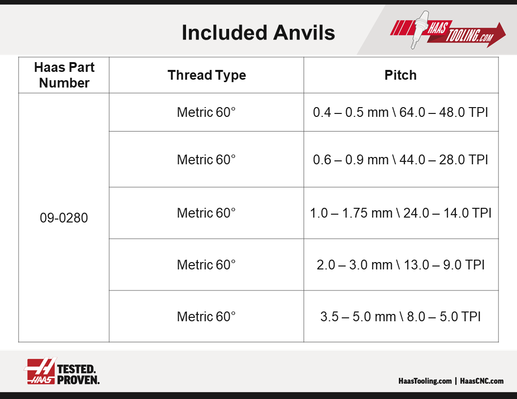

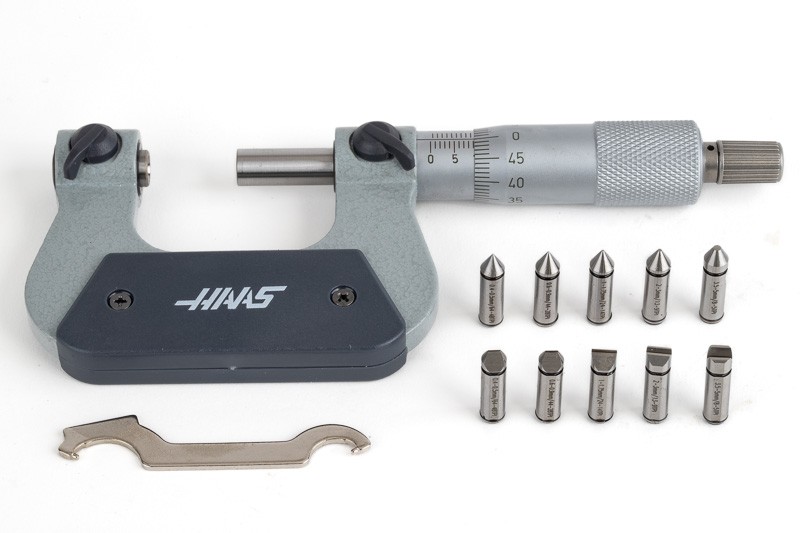

Screw thread micrometers are used to measure the thread pitch or threads per unit length of screw threads. This micrometer features a metric thimble graduation, stainless steel anvils, and a stainless steel spindle. Included anvils can be found in chart below.

Anvil Pairs 5
