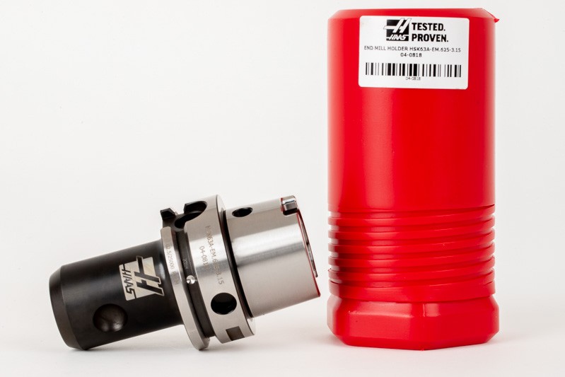

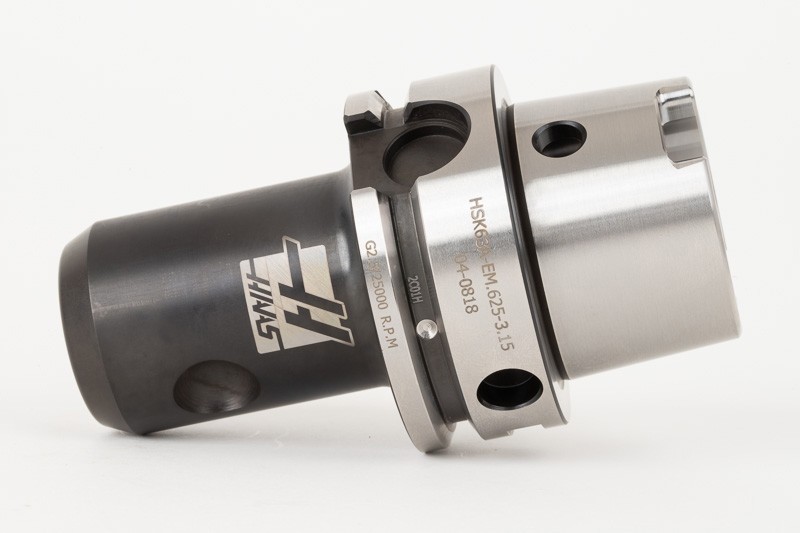

HSK63A 5/8" End Mill Holder x 3.15" Gage Length, TSC
Part #: 04-0818
HSK63A-EM-0.625-3.15
Price: 152.95 ( / unit)
107.97
This HSK63A end mill holder has a 0.625 in \ 5/8" bore diameter and a 3.15" gage length. It uses the Weldon flat standard with side-lock clamping for secure clamping of cutting tools. It is through-tool coolant (TSC) capable.
Taper HSK63A

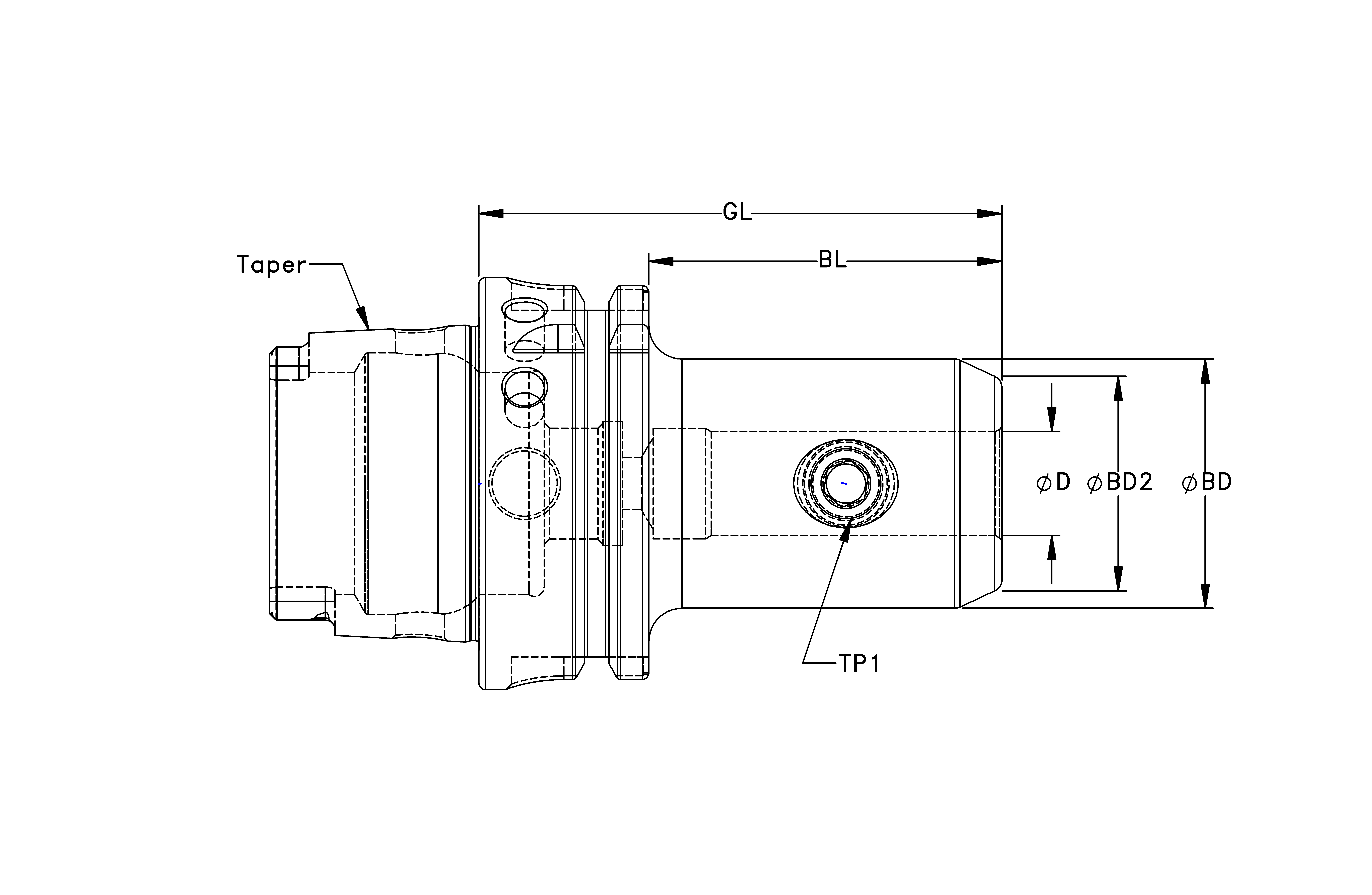

[ØD] Bore Diameter 0.625 in \ 5/8"
[ØBD] Body Diameter 1.5 in
[ØBD2] Minimum Body Diameter 1.25 in
[GL] Gage Length 3.15 in
[BL] Body Length 2.126 in
[TP1] Thread 1/2"-20
Concentricity 0.0001 in
Balanced to RPM 25000
Bore Tolerance H5
Through Tool Coolant Yes
Spindle Drive Slots Yes
Weight 3.7 lbs \ 1.7 kg
