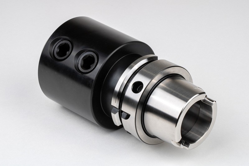

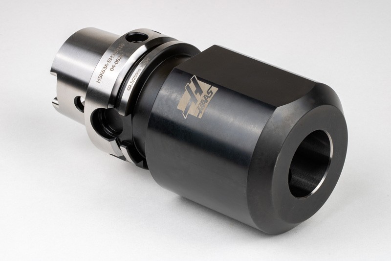

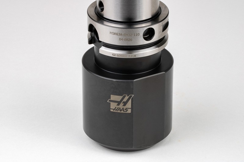

This HSK63A end mill holder has a 32mm bore diameter and a 110mm gage length. It uses the Weldon flat standard with side-lock clamping for secure clamping of cutting tools. It is through-tool coolant (TSC) capable.
Taper HSK63A
[ØD] Bore Diameter 32.0 mm
[ØBD] Body Diameter 72.0 mm
[ØBD2] Minimum Body Diameter 56.0 mm
[GL] Gage Length 110.0 mm
[BL] Body Length 84.0 mm
[TP1] Thread M20-2.0
Concentricity 0.003 mm
Balanced to RPM 25000
Bore Tolerance H5
Through Tool Coolant Yes
Spindle Drive Slots Yes
Weight 5.8 lbs \ 2.7 kg
