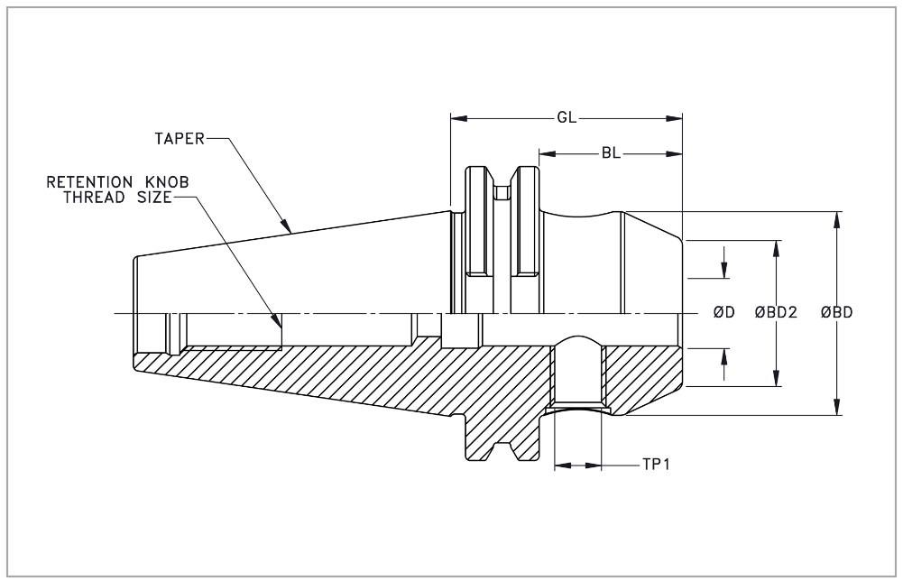

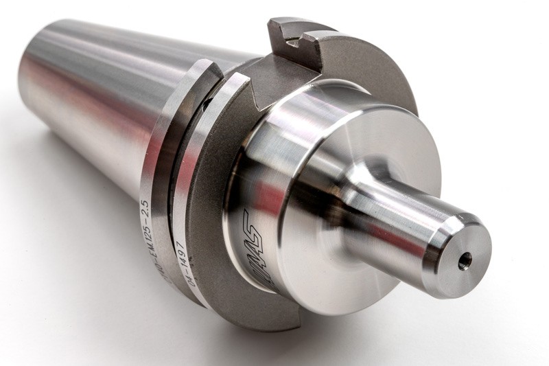

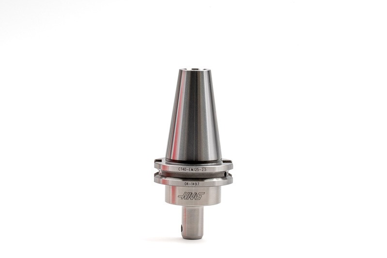

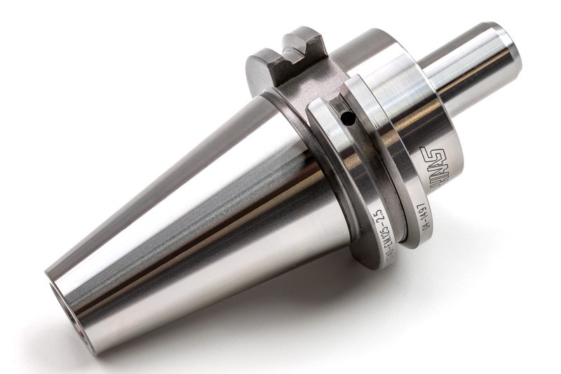

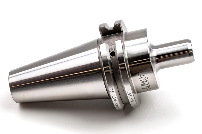

This CAT40 end mill holder has a 0.125 in \ 1/8" bore diameter and a 2-1/2" gage length. It uses the Weldon flat standard with side-lock clamping for secure clamping of cutting tools. It is through-tool coolant (TSC) capable, with a 5/8"-11 pull stud/retention knob thread.
Taper CT40
[ØD] Bore Diameter 0.125 in \ 1/8"
[ØBD] Body Diameter 1.75 in
[ØBD2] Minimum Body Diameter 0.69 in
[GL] Gage Length 2.5 in
[BL] Body Length 1.75 in
[TP1] Thread #8-32
Concentricity 0.0002 in
Balanced to RPM 25000
Bore Tolerance H5
Retention Knob Thread Size 5/8"-11
Through Tool Coolant Yes
Spindle Drive Slots Yes
Weight 2.4 lbs \ 1.1 kg
