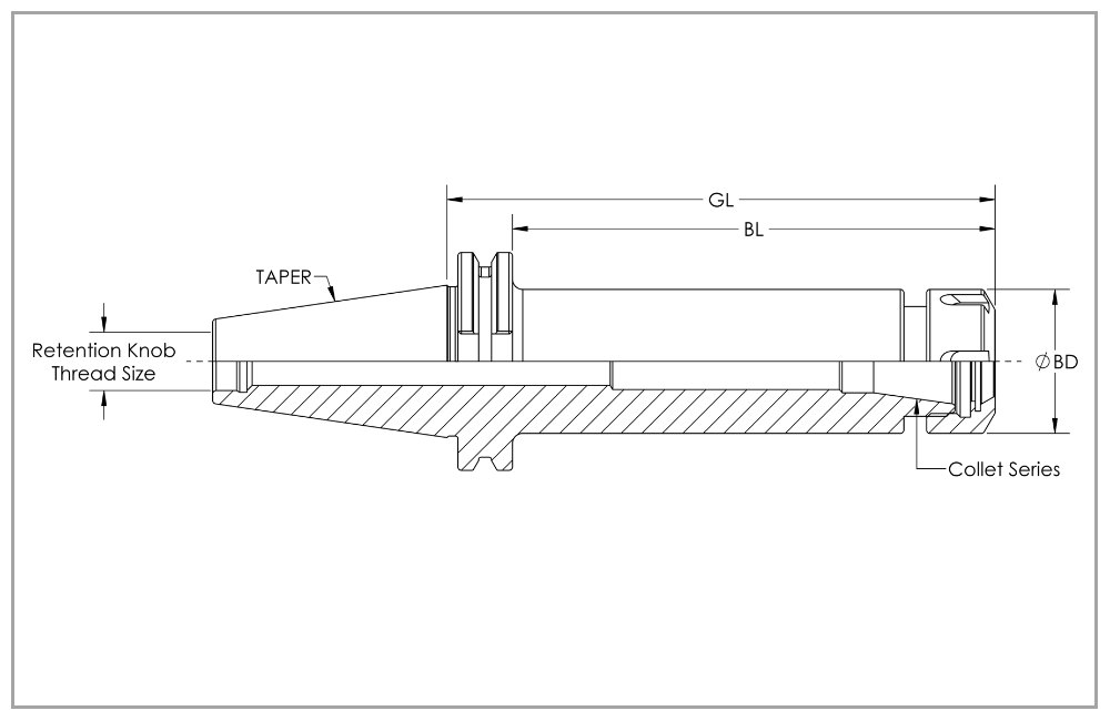

This SK40 \ DIN 69871 ER25 collet chuck accepts a variety of ER25 collet styles, and has a 160mm gage length. The double-taper collet design provides high clamping force for round, smooth shank tools, and offers a wide gripping range with excellent TIR and balance. It is through-tool coolant (TSC) capable, with a M16x2.0 pull stud/retention knob thread.
Taper SK40 \ DIN 69871
Collet Series ER-25
[ØBD] Body Diameter 42.0 mm
[GL] Gage Length 160.0 mm
[BL] Body Length 140.9 mm
Concentricity 0.008 mm
Balanced to RPM 20000
Retention Knob Thread Size M16X2.0
Through Tool Coolant Yes
Spindle Drive Slots Yes
Weight 4.7 lbs \ 2.1 kg
