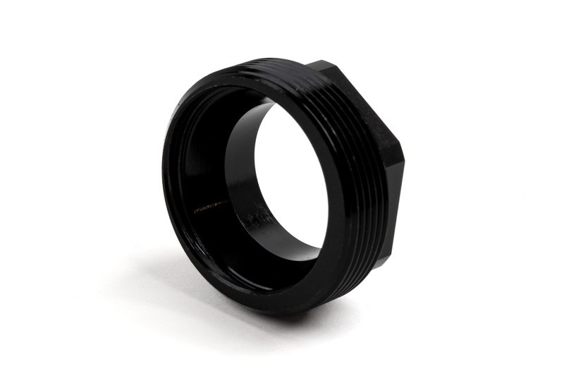

ER32 Externally Threaded Hex Collet Nut
Part #: 06-0222
