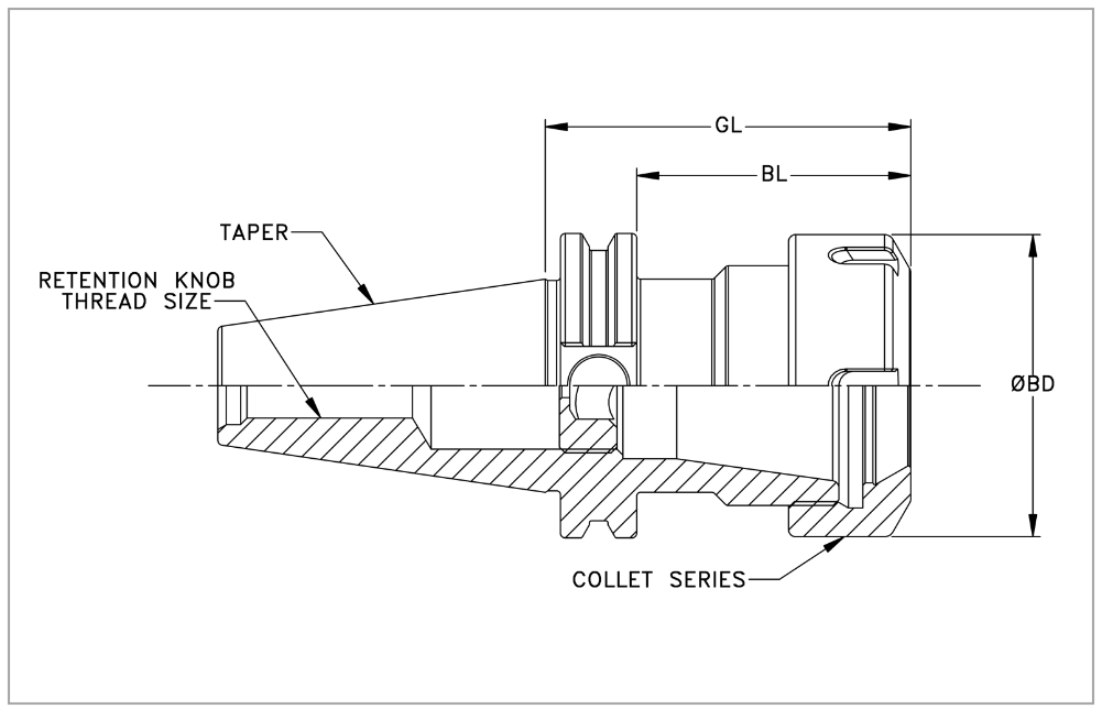

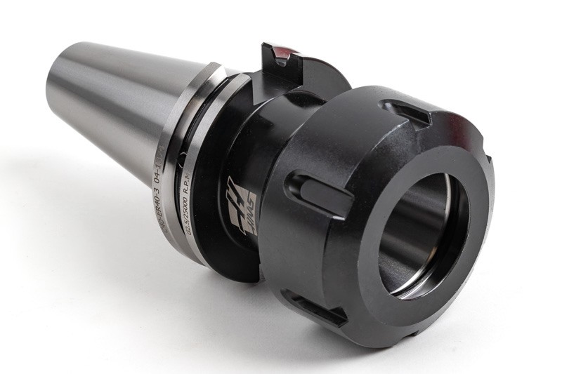

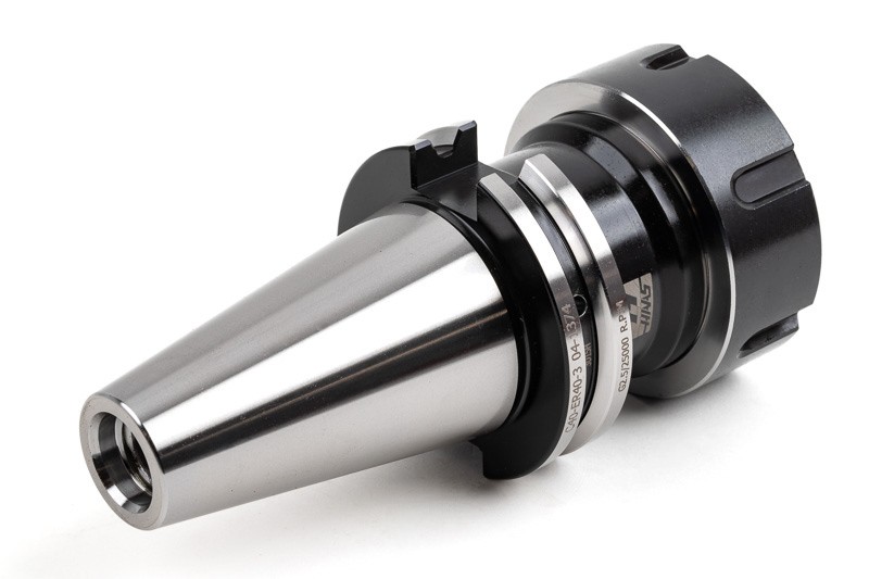

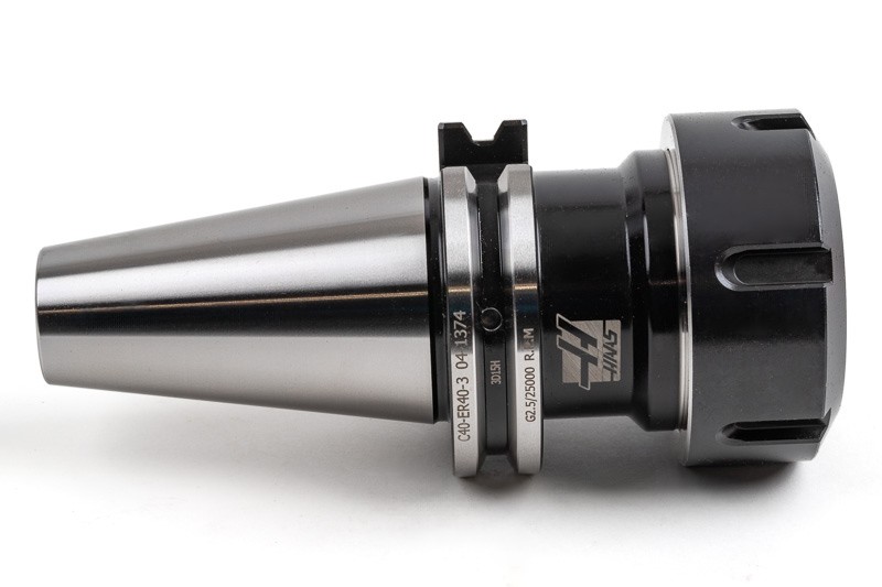

This CAT40 ER40 collet chuck accepts a variety of ER40 collet styles, and has a 3" gage length. The double-taper collet design provides high clamping force for round, smooth shank tools, and offers a wide gripping range with excellent TIR and balance. It is through-tool coolant (TSC) capable, with a 5/8"-11 pull stud/retention knob thread.
Taper CT40
Collet Series ER-40
[ØBD] Body Diameter 2.48 in
[GL] Gage Length 3.0 in
[BL] Body Length 2.25 in
Concentricity 0.0001 in
Balanced to RPM 25,000
Retention Knob Thread Size 5/8"-11
Through Tool Coolant Yes
Spindle Drive Slots Yes
Weight 2.8 lbs \ 1.3 kg
