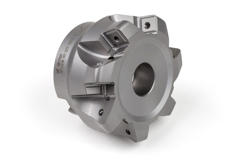

HCSHF, 80mm Ø Shell Mill, 27mm Pilot Bore x 17.23° Lead Angle, 7 Flute, High Feed, TSC
Part #: 01-0737
RETAIL PRICE: $346.95 $7,448.95 $2,216.95 $297.95 $1,340.95 $3,128.95
$242.97
6349.97
1889.97
253.97
1142.97
2666.97
