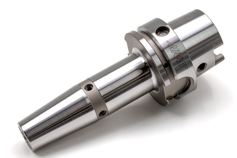

HSK63A 3/8" Shrink Fit Holder x 5.12" Gage Length, TSC
Part #: 04-1540
HSK63A-SF.375-5.12
Price: 209.95 ( / unit)
This HSK63A shrink fit holder has a 0.375 in \ 3/8" bore diameter, and a 5.12" gage length. It offers very low runout (0.0001" TIR), very high grip force, and quick tool changeovers when used in conjuction with Haas shrink fit machines. It is through-tool coolant (TSC) capable.
Taper HSK63A
[ØD] Bore Diameter 0.375 in \ 3/8"
[ØBD2] Minimum Body Diameter 0.945 in
[ØBD] Maximum Body Diameter 1.26 in
[GL] Gage Length 5.118 in
[BL] Body Length 4.09 in
[OAL] Overall Length 6.38 in
[LSCN] Minimum Clamping Length 1.24 in
[LSCX] Maximum Clamping Length 1.713 in
[SIG°] Angle 4.5 °
Concentricity 0.00012 in
Balanced to RPM 25,000
Retention Knob Thread Size 5/8"-11
Through Tool Coolant Yes
Weight 2.7 lbs \ 1.2 kg
