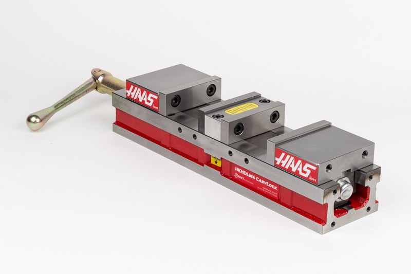

This is the same high-quality DX6 Kurt vise that we’ve all come to know and love – designed and branded specifically for Haas. Pair your machine with proven, great-quality tools and workholding.
Double-Station, Fixed-Jaw

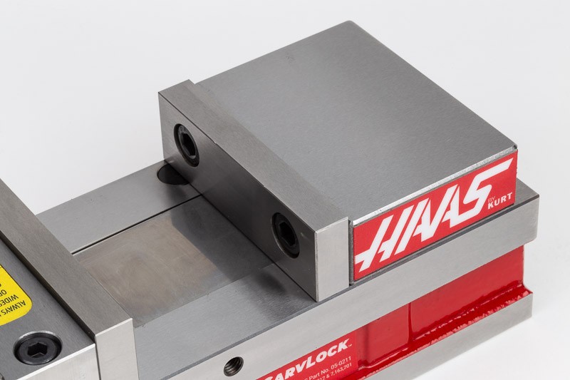

Haas double-station vises allow you to mount two workpieces in roughly the same workspace as a single-station vise, for high-density workholding. The vises have a stationary center jaw, with two moveable jaws that are adjusted using a single screw. The two clamping stations have the ability to clamp the same or dissimilar sized parts, with repeatable clamping to 0.0002". The simple bolt-on jaws are easily changed or reversed, without disassembling the vise, and the jaws can be attached to the outside ends of the jaw plates to accommodate larger workpieces. Replacement hard jaws, as well as machinable steel and aluminum soft jaws are available. A vise handle is included.
  • Two clamping stations
  • 80,000 psi ductile iron body, with steel components
  • Precision-ground sides allow side mounting
  • Angle-lock system reduces jaw lift
  • Fixed height simplifies multi-vise setups
  • Includes standard hard jaws

Vise Type Manual
Vise Holding Type Fixed Jaw
Number of Stations 2
[BL] Body Length 16.375 in \ 415.92 mm
[BH] Body Height 2.375 in \ 60.32 mm
[H] Height of Screw Hole 0.687 in \ 17.45 mm
[JH] Jaw Height 1.235 in \ 31.37 mm
[JW] Jaw Width 4.0 in \ 100.0 mm
[b] Dimension 3.0 in \ 76.2 mm
[OAL] Overall Length 17.76 in \ 451.1 mm
[OAH] Overall Height 3.61 in \ 91.69 mm
[OAW] Overall Width 4.0 in \ 101.6 mm
[J1] Inner Jaw Range 0.0-2.98 in \ 0.0-75.7 mm
[J3] Outer Jaw Range 9.25-16.38 in \ 235.0-416.1 mm
[VO] Vise Opening 3.0 in \ 75.0 mm
[BT] Base Thickness 0.7 in \ 17.78 mm
[S] Screw Spacing 2.5 in \ 63.5 mm
[ZPC] Zero Point Connections 0
[TP] Thread Pitch M10x1.5
[W] Wrench Size 14.0 mm
Weight 34.0 lbs \ 15.0 kg
Country of Origin USA
