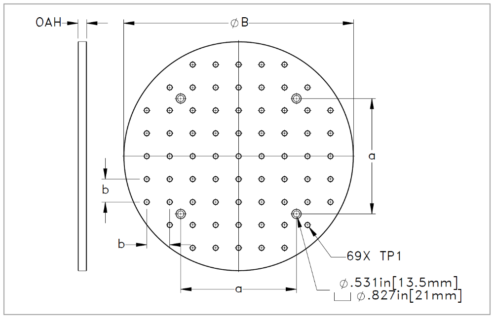

UMC-750 Round Grid Aluminum Tooling Fixture Subplate, 19.7" Base Diameter
Part #: 08-1883
UMC-750 PLATE ALUM PATTERN W/ HARDWARE
Price: $881.95 ( / unit)
$749.97
$712.47 (Save 5%)
  • These are designed to be used only with UMC-750 machines with standard T-slot platter and come with all hardware necessary to install to T-Slot platter
Machine Models UMC-750
Pallet Pool Compatible No
Plate Style Round
Plate Design Grid
Material Aluminum
[OAH] Overall Height 0.984 in \ 25.0 mm
[ØB] Base Diameter 19.7 in \ 500.4 mm
[a] Dimension 9.92 in \ 252.0 mm
[b] Dimension 1.969 in \ 50.0 mm
[TP1] Thread M12x1.75
Parallelism 0.002 in \ 0.051 mm
Weight 28.2 lbs \ 12.8 kg
