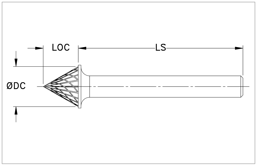

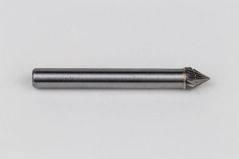

This double cut, carbide 60° cone burr has a 6mm cutting diameter, with a 6mm smooth shank, and a 5mm length of cut (LOC). It is uncoated and made to cut steel, stainless steel, cast iron, high temp. alloys, and hardened metals.
ISO MATERIAL CHART
Primary Workpiece Material M - Stainless Steel, K - Cast Iron, H - Hardened Steels, S - High Temp Alloys, P - Steel
Material Carbide
Coating Uncoated
Cut Type Double Cut
Burr Shape Cone, 60°
[ØDC] Cutting Diameter 6.0 mm
[ØDMM] Shank Diameter 6.0 mm
[LOC] Length Of Cut 5.0 mm
[LS] Shank Length 45.0 mm
Cutting Direction Right
