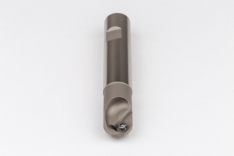

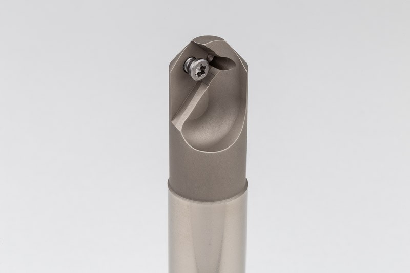

This 45-degree indexable chamfer mill has a 7mm minimum cutting diameter and a maximum cutting diameter of 21.89mm. It has a 20mm shank diameter and an overall length of 120mm. It takes 1 square chamfer insert (SPㅁㅁ1104ㅁㅁ), which is available in grades for steel, stainless steel, cast iron, aluminum/non-ferrous materials, and hardened metals.
Tool Or Insert Tool
[ØDC] Cutting Diameter 7.0 mm
[ØDCX] Max Cutting Diameter 21.89 mm
[ØDMM] Shank Diameter 20.0 mm
[OAL] Overall Length 120.0 mm
[LH] Head Length 40.0 mm
[Ap] Max. Cutting Depth 6.98 mm
[SIG°] Chamfer Angle 45 Degree
[NOF] Number of Flutes 1
Insert Size SPㅁㅁ1104ㅁㅁ
Weight 0.6 lbs \ 0.3 kg
