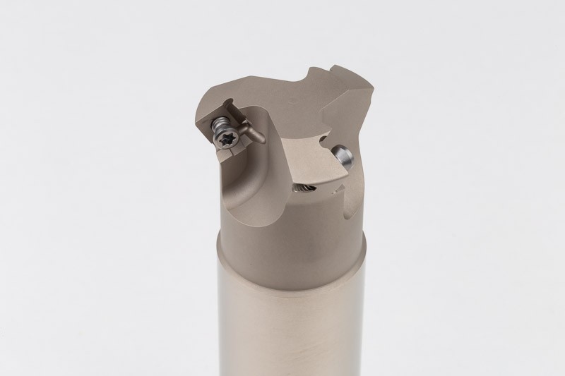

This 60-degree indexable chamfer mill has a 25mm minimum cutting diameter and a maximum cutting diameter of 43.32mm. It has a 32mm shank diameter and an overall length of 120mm. It takes 3 square chamfer inserts (SPㅁㅁ1104ㅁㅁ), which are available in grades for steel, stainless steel, cast iron, aluminum/non-ferrous materials, and hardened metals.
Tool Or Insert Tool
[ØDC] Cutting Diameter 25.0 mm
[ØDCX] Max Cutting Diameter 43.32 mm
[ØDMM] Shank Diameter 32.0 mm
[OAL] Overall Length 120.0 mm
[LH] Head Length 40.0 mm
[Ap] Max. Cutting Depth 4.95 mm
[SIG°] Chamfer Angle 60 Degree
[NOF] Number of Flutes 3
Insert Size SPㅁㅁ1104ㅁㅁ
Weight 1.5 lbs \ 0.7 kg
