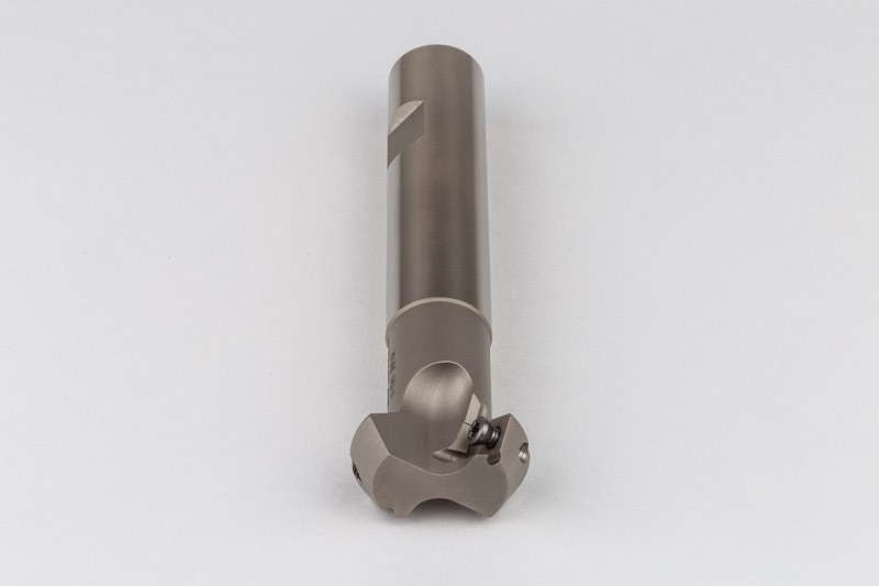

30° Indexable Chamfer Mill, 25.0mm - 35.57mm Diameter x 20.0mm Shank x 120.0mm Overall Length, 2 Inserts
Part #: 01-0540
HCM-30-34-20-2 30 DEG CHAMFER MILL
Price: 78.95 ( / unit)
Price: 2348.95 ( / unit)
Price: 698.95 ( / unit)
Price: 93.95 ( / unit)
Price: 422.95 ( / unit)
Price: 986.95 ( / unit)
63.97
1649.97
490.97
65.97
296.97
692.97
This 30-degree indexable chamfer mill has a 25mm minimum cutting diameter and a maximum cutting diameter of 35.58mm. It has a 20mm shank diameter and an overall length of 120mm. It takes 2 square chamfer inserts (SPㅁㅁ1104ㅁㅁ), which are available in grades for steel, stainless steel, cast iron, aluminum/non-ferrous materials, and hardened metals.
Tool Or Insert Tool
[ØDC] Cutting Diameter 25.0 mm
[ØDCX] Max Cutting Diameter 35.58 mm
[ØDMM] Shank Diameter 20.0 mm
[OAL] Overall Length 120.0 mm
[LH] Head Length 40.0 mm
[Ap] Max. Cutting Depth 8.57 mm
[SIG°] Chamfer Angle 30 Degree
[NOF] Number of Flutes 2
Insert Size SPㅁㅁ1104ㅁㅁ
Weight 0.7 lbs \ 0.3 kg
