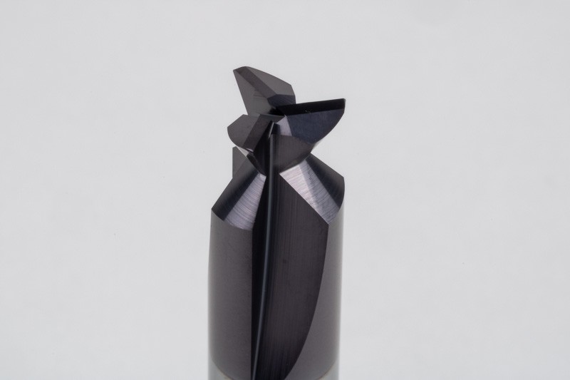

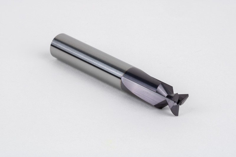

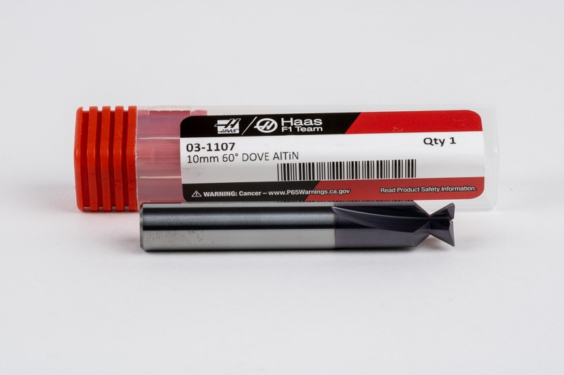

This 60-degree 3-flute carbide dovetail cutter has a 10mm cutting diameter, with a 10mm smooth shank, 4.75mm length of cut (LOC), 0.25mm corner radius, and a 64mm overall length. It is AlTiN coated, and made to cut steel, stainless steel, cast iron, high temp. alloys, and hardened metals.
