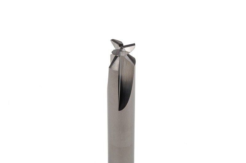

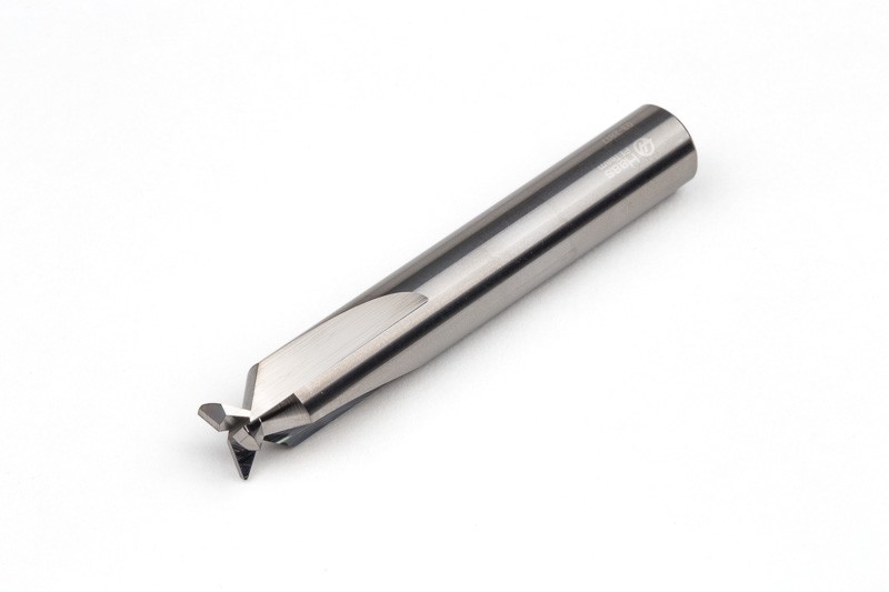

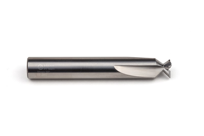

This 90-degree 3-flute carbide dovetail cutter has a 10mm cutting diameter, with a 10mm smooth shank, 3.18mm length of cut (LOC), 0.25mm corner radius, and a 64mm overall length. It is uncoated, and made to cut aluminum/non-ferrous materials.

Dovetail cutters are specialized tools for cutting angled or trapezoidal-shaped grooves (dovetails) into a workpiece. They are used to cut the male and female parts of dovetail joints for industrial slides, as well as for cutting bevels and undercuts, and for deburring parts.
Dovetail cutters are also used to cut external features on workpieces for clamping in dovetail-style workholding. The dovetail creates a strong and secure area for clamping, while sacrificing minimal raw material, allowing more surface area of the part to be exposed to the cutting tool. This makes dovetails a great way to securely hold your workpiece during 5-axis operations.

TIPS:
  • Rough slots with an end mill first
  • Calculate feedrates based on the smaller neck diameter
  • Calculate speeds based on the larger end diameter
  • Take shallow depths of cut

[ØDC] Cutting Diameter 10.0 mm
[ØDMM] Shank Diameter 10.0 mm
[ØN] Neck Diameter 3.94 mm
[LOC] Length Of Cut 3.18 mm
[OAL] Overall Length 64.0 mm
[NOF] Number of Flutes 3
[CHW\RE] Chamfer \ Radius Size 0.25 mm
[SIG°] Included Angle 90
