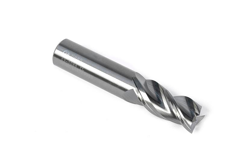

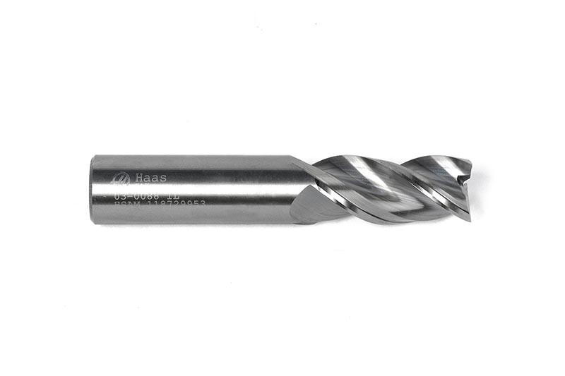

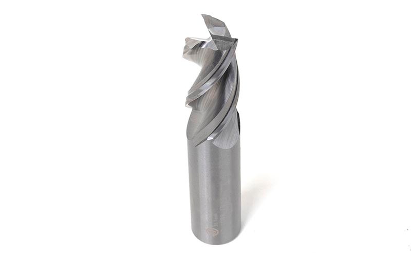

3/4" Dia. Carbide End Mill, 3 Flute, Uncoated, 3/4" Smooth Shank x 1-1/2" LOC, Square Profile, HSAM1
Part #: 03-0088
ALUM-MILL 3/4" END MILL 3 FLUTE
Price: 115.95 ( / unit)
81.97
This HSAM1 3-flute carbide end mill has a 0.75 in \ 3/4" cutting diameter, with a 3/4" smooth shank, 1-1/2" length of cut (LOC), square profile, and a 4" overall length. It is uncoated, and made to cut aluminum/non-ferrous materials. This end mill is designed to center-cut, and the unique, variable pitch configuration helps to reduce unwanted harmonics and vibrations.

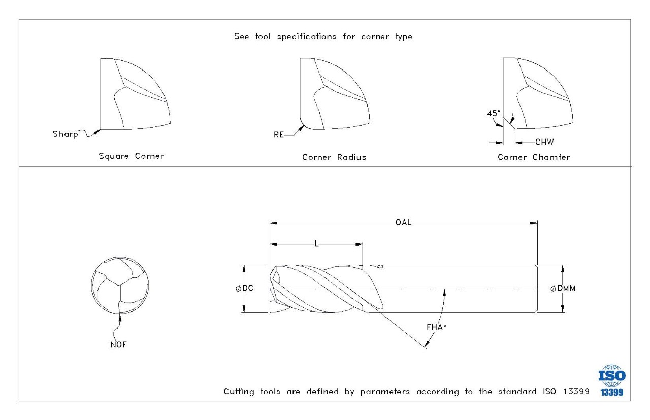

ISO MATERIAL CHART
[ØDC] Cutting Diameter 0.75 in \ 3/4"
Haas Milling Series HSAM1
Material Carbide
Coating Uncoated
Corner Type Square
Shank Type Smooth
[ØDMM] Shank Diameter 0.75 in
[LOC] Length Of Cut 1.5 in
[OAL] Overall Length 4.0 in
[NOF] Number of Flutes 3
[FHA°] Helix Angle 38
Cutting Direction Right
Center Cutting Yes
Variable Pitch Yes
Through Spindle Coolant No
Weight 1.0 lbs \ 0.5 kg
