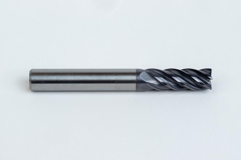

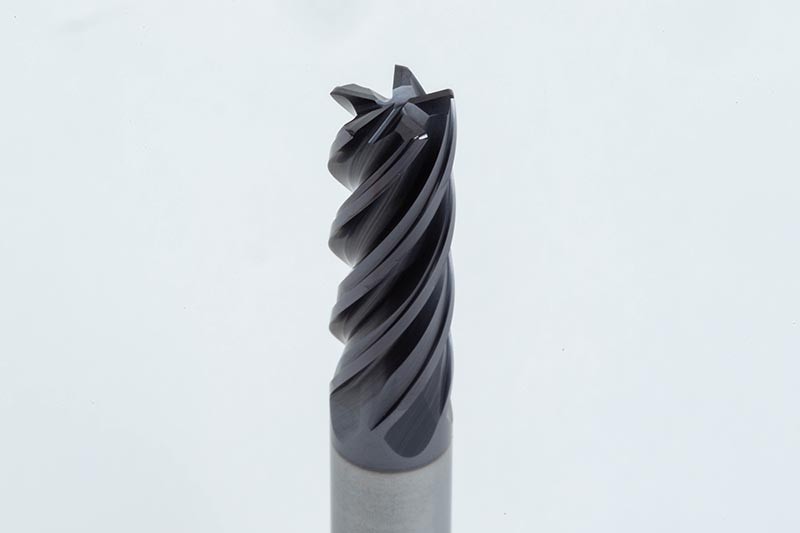

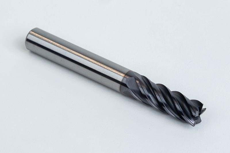

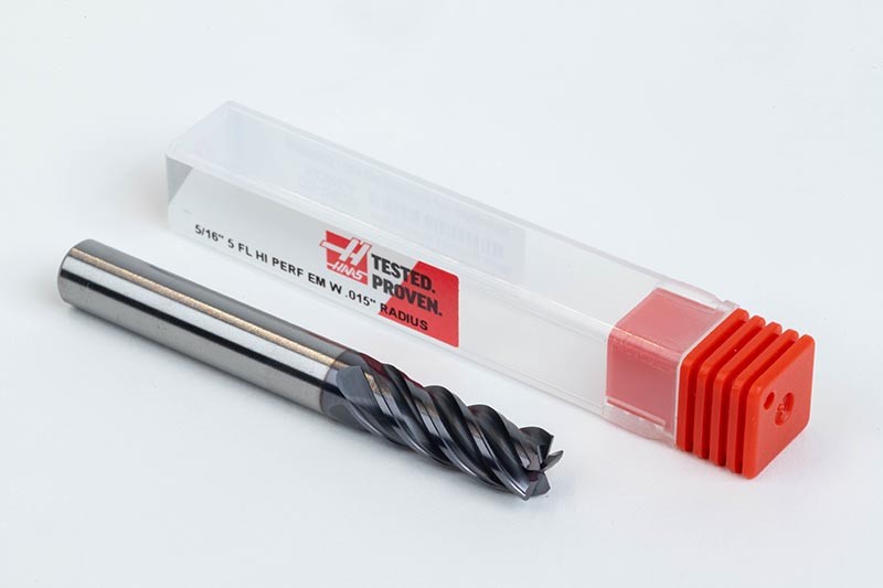

5/16" Dia. Carbide End Mill, 5 Flute, AlTiN Coated, 5/16" Smooth Shank x 13/16" LOC, 0.015" Radius, HTM
Part #: 03-0629
5/16" 5 FL HI PERF EM W .015" RADIUS
Price: 27.95 ( / unit)
22.97
This HTM 5-flute carbide end mill has a 0.3125 in \ 5/16" cutting diameter, with a 5/16" smooth shank, 13/16" length of cut (LOC), 0.015" radius, and a 2-1/2" overall length. It is AlTiN coated, and made to cut stainless steel and high-temp. alloys, but is capable of cutting some grades of steel and cast iron. This end mill is designed to center-cut, and the unique, variable pitch configuration helps to reduce unwanted harmonics and vibrations.
ISO Material Chart
[ØDC] Cutting Diameter 0.3125 in \ 5/16"
Haas Milling Series HTM
Primary Workpiece Material S - High Temp Alloys, M - Stainless Steel
Secondary Workpiece Material P - Steel, K - Cast Iron
Material Carbide
Coating AlTiN
Corner Type Radius
Shank Type Smooth
[ØDMM] Shank Diameter 0.3125 in
[LOC] Length Of Cut 0.813 in
[OAL] Overall Length 2.5 in
[NOF] Number of Flutes 5
[CHW\RE] Chamfer \ Radius Size 0.015 in
[FHA°] Helix Angle 38
Cutting Direction Right
Center Cutting Yes
Variable Pitch Yes
Through Spindle Coolant No
Weight 0.2 lbs \ 0.1 kg
