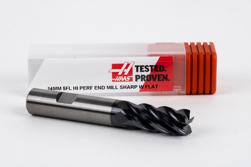

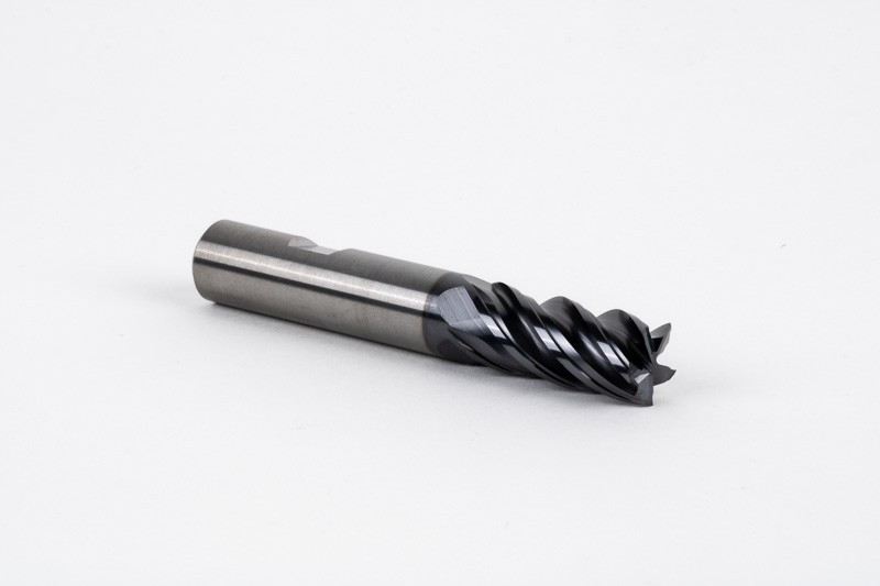

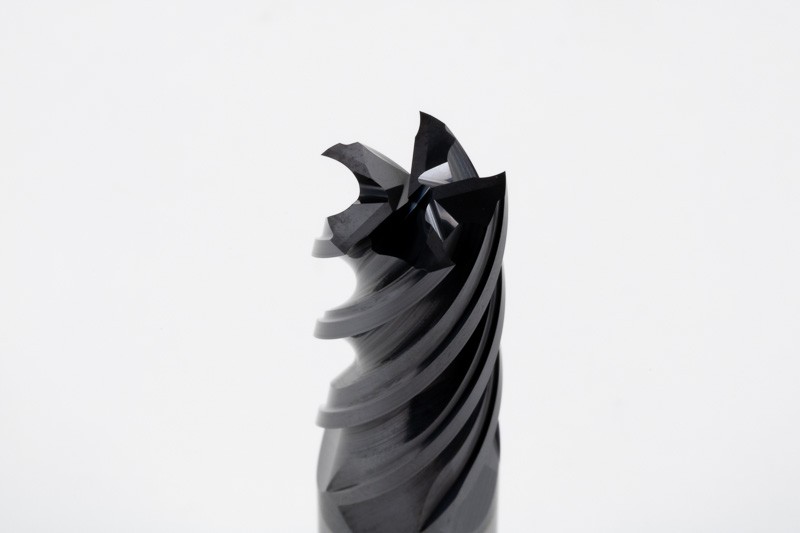

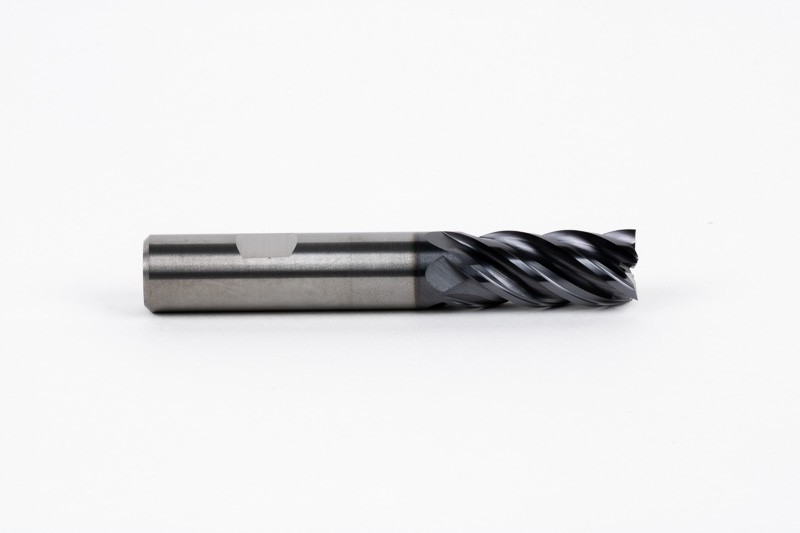

This HTM 5-flute carbide end mill has a 14mm cutting diameter, with a 14mm weldon shank, 30mm length of cut (LOC), square profile, and a 88mm overall length. It is AlTiN coated, and made to cut stainless steel and high-temp. alloys, but is capable of cutting some grades of steel and cast iron. This end mill is designed to center-cut, and the unique, variable pitch configuration helps to reduce unwanted harmonics and vibrations.
ISO Material Chart
[ØDC] Cutting Diameter 14.0 mm
Haas Milling Series HTM
Primary Workpiece Material M - Stainless Steel, S - High Temp Alloys
Secondary Workpiece Material P - Steel, K - Cast Iron
Material Carbide
Coating AlTiN
Corner Type Square
Shank Type Weldon
[ØDMM] Shank Diameter 14.0 mm
[LOC] Length Of Cut 30.0 mm
[OAL] Overall Length 88.0 mm
[NOF] Number of Flutes 5
[FHA°] Helix Angle 38
Cutting Direction Right
Center Cutting Yes
Variable Pitch Yes
Through Spindle Coolant No
Weight 0.3 lbs \ 0.2 kg
