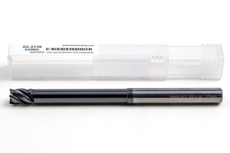

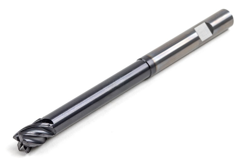

3/8" Dia. Long Carbide End Mill, 5 Flute, AlTiN Coated, 3/8" Weldon Shank x 1/2" LOC x 2-3/4" Neck Length, 0.01" Radius, HTM
Part #: 03-3139
EM 5FL 3/8(R.01)x3/8x1/2x2-3/4x5 WF
Price: 52.95 ( / unit)
39.97

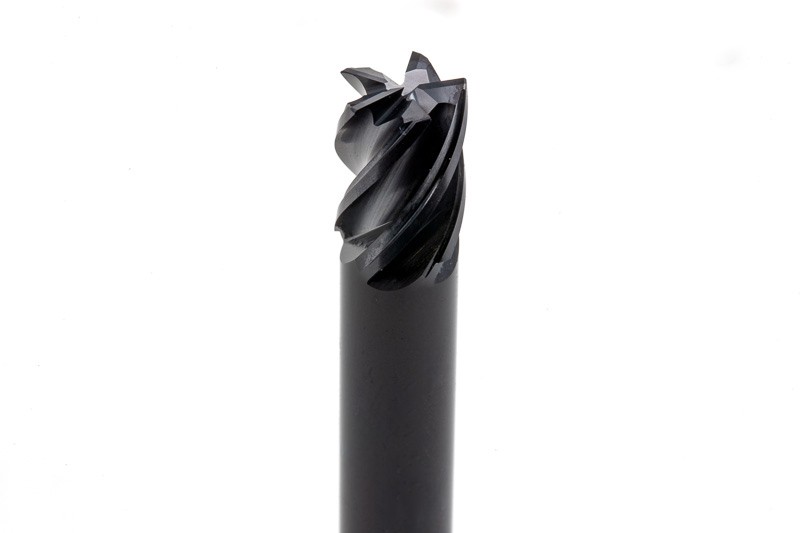

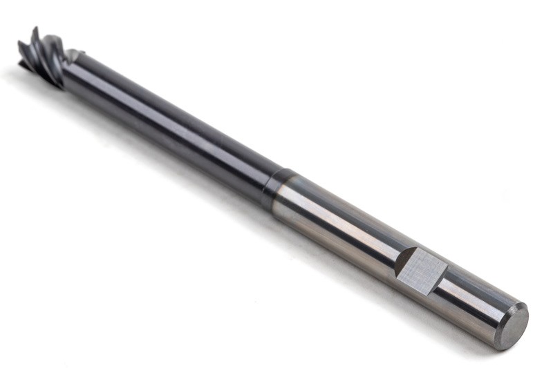

This HTM 5-flute long carbide end mill has a 0.375 in \ 3/8" cutting diameter, with a 3/8" weldon shank, 1/2" length of cut (LOC), 0.01" radius, and a 5" overall length. The extended shank tapers down to a 0.344" neck diameter, with a 2-3/4" neck length. It is AlTiN coated, and made to cut stainless steel and high-temp. alloys, but is capable of cutting some grades of steel and cast iron. This end mill is designed to center-cut.
ISO Material Chart
[ØDC] Cutting Diameter 0.375 in \ 3/8"
Haas Milling Series HTM
Primary Workpiece Material S - High Temp Alloys, M - Stainless Steel
Secondary Workpiece Material P - Steel, K - Cast Iron
Material Carbide
Coating AlTiN
Corner Type Radius
Shank Type Weldon
[ØDMM] Shank Diameter 0.375 in
[LOC] Length Of Cut 0.5 in
[ØN] Neck Diameter 0.344 in
[LN] Neck Length 2.75 in
[OAL] Overall Length 5.0 in
[NOF] Number of Flutes 5
[CHW\RE] Chamfer \ Radius Size 0.01 in
[FHA°] Helix Angle 38
Cutting Direction Right
Center Cutting Yes
Variable Pitch No
Through Spindle Coolant No
Weight 0.3 lbs \ 0.1 kg
