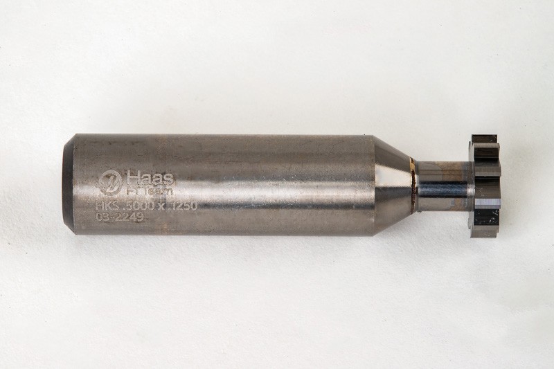

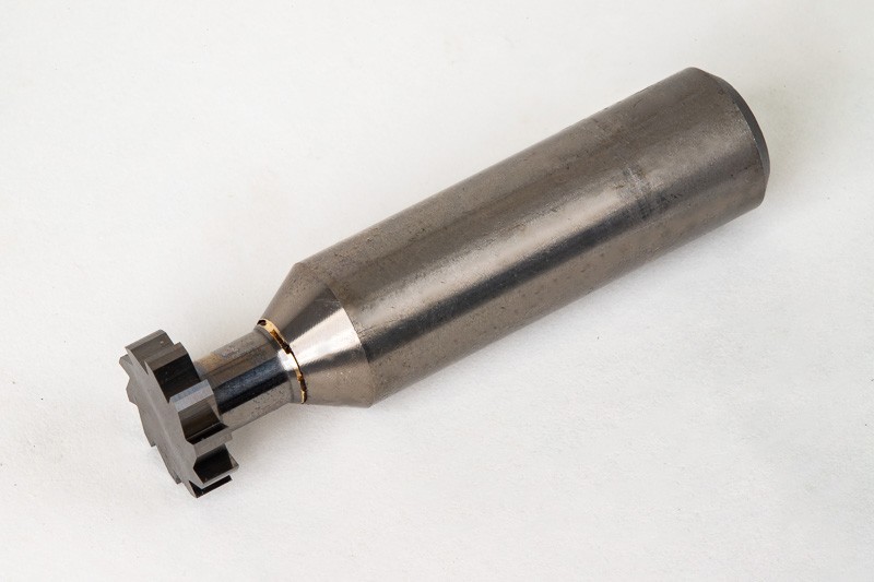

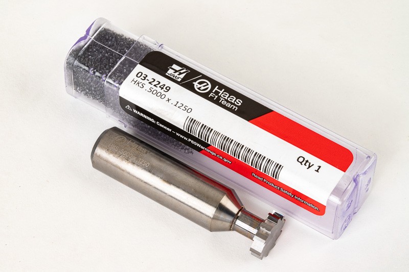

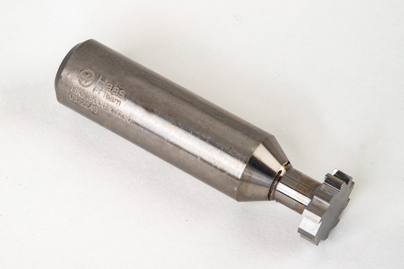

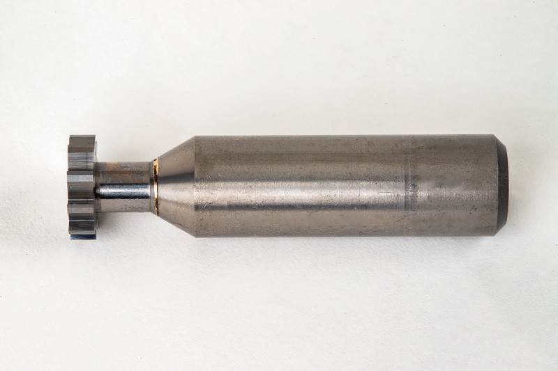

1/2" Dia. Carbide Straight Tooth Keyseat Cutter, 10 Flute, Uncoated, 1/2" Smooth Shank x 1/8" Cut Width
Part #: 03-2249
HKS .5000 X .1250
Price: 92.95 ( / unit)
65.97
This 10-flute carbide straight-tooth keyseat cutter has a 0.5 in \ 1/2" cutting diameter, with a 1/2" smooth shank, 1/8" cut width, and a 2-1/8" overall length. It is uncoated, and made to cut steel, stainless steel, cast iron, aluminum/non-ferrous materials, and high temp. alloys.
ISO MATERIAL CHART
Primary Workpiece Material S - High Temp Alloys, N - Aluminum, K - Cast Iron, M - Stainless Steel, P - Steel
Material Carbide
Coating Uncoated
Tooth Type Straight
Shank Type Smooth
[ØDC] Cutting Diameter 0.5 in \ 1/2"
Cutting Diameter Tolerance + 0.010 \ + 0.015 in
[ØDMM] Shank Diameter 0.5 in
[ØN] Neck Diameter 0.25 in
[CW] Cutting Width 0.125 in
[OAL] Overall Length 2.125 in
[NOF] Number of Flutes 10
Cutting Direction Right
Weight 0.2 lbs \ 0.1 kg
Country of Origin USA
