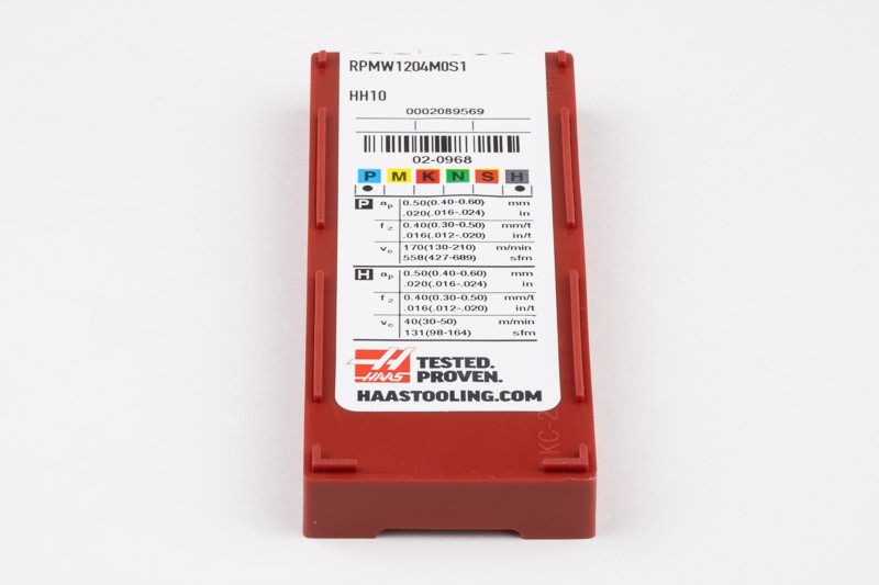

INSERT STYLES & GRADES
Insert Overview
HRPP - High-Quality Surface Finish, Multiple Tool Path Insert
✓ Found in the Die and Mold Industry
✓ Can handle a maximum depth of cut upwards of .236 (5.99mm)
✓ High feed rates for quick removal of material
✓ Capable of face milling, shoulder milling, slotting, ramping, helical milling, and copy milling toolpaths
Insert Style
HRPP
HAAS ROUND POSITIVE POSITIVE
TOOLPATH TYPE
FACE MILLING, SHOULDER MILLING, SLOTTING, RAMPING, HELICAL MILLING, COPY MILLING
Round edge | D.O.C. max. .236 (5.99mm)
• Superior perpendicularity and minimized cutting loads
• Optimized for high-quality surface finishes
• High rake angle lowers cutting loads and minimizes burrs
• High-speed and high-feed capability improve productivity
Insert Grade
HH10
APPLICABLE WORKPIECE MATERIALS
● P - STEEL
PVD coated grade for roughing pre-hardened steels. It is ideal for interrupted cutting of hardened steels, and wet cutting where thermal shock is present. The ultra-fine substrate provides high toughness and improved wear resistance, while the PVD surface treatment improves surface finish.
●  Primary Workpiece Material | ○  Secondary Workpiece Material
TOOLPATH LEGEND
FACE MILLING
SHOULDER MILLING
SLOTTING
RAMPING
HELICAL MILLING
COPY MILLING
PLUNGE MILLING
CHAMFER MILLING
ISO MATERIAL CHART
Insert Style Round
Toolpath Type Shoulder Milling, Ramping, Helical Milling, Slotting, Copy Milling, Face Milling
Milling Cutter Series HRPP - Haas Round + / +
Grade HH10
Material Carbide
Chipbreaker N1
Chipbreaker (Old Designation) S1
[IC] Inscribed Circle Diameter 0.472 in \ 12.0 mm
[INSL] Insert Length 0.472 in \ 12.0 mm
[RE] Corner Radius 0.236 in \ 6.0 mm
[D1] Insert Hole Size 0.177 in \ 4.5 mm
[Ap] Max. Cutting Depth 0.236 in \ 6.0 mm
[AN°] Clearance Angle 11
