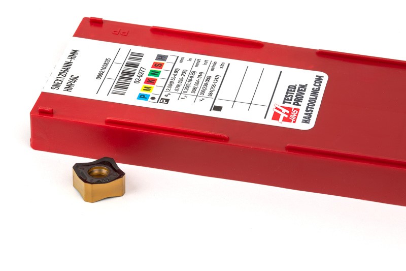

HCSNP, Carbide Shell Mill Inserts, Square Negative Positive, Grade HMP40C - Pack of 10
Part #: 02-0977
SNEX1206ANN HMP40C
Price: 125.95 ( / unit)
Price: 2748.95 ( / unit)
Price: 818.95 ( / unit)
Price: 109.95 ( / unit)
Price: 494.95 ( / unit)
Price: 1154.95 ( / unit)
81.97
1924.97
572.97
76.97
346.97
808.97
  • SPEEDS & FEEDS (INCH)
  • SPEEDS & FEEDS (METRIC)
INSERT STYLES & GRADES
Insert Overview
HCSNP - 8-Sided Insert for Finish Face Milling
✓ Designed for finish-facing operations
✓ Positive radial rake angle
✓ Low cutting loads and smooth cutting
✓ Extra thick and double-sided with 8 different cutting edges
Insert Style
HCSNP
HAAS C SQUARE NEGATIVE POSITIVE
TOOLPATH TYPE
FACE MILLING
45° cutting edge | D.O.C. max. .236" (5.99mm)
• Negative axial rake, positive radial rake
• Double-sided, extra-thick insert with 8 cutting edges
• Low cutting loads and excellent smooth cutting
Insert Grade
HMP40C
APPLICABLE WORKPIECE MATERIALS
● P - STEEL
●  K - CAST IRON
Primary grade for tough steels and cast iron. CVD-coated carbide grade for interrupted cutting in steel, and continuous cutting in cast iron. High wear resistance, and resistance to plastic deformation. The substrate has high toughness and thermal conductivity, with a high-performance CVD coating layer that provides excellent heat resistance. Surface treatment after coating with MT-TiCN + Al₂O₃ provides high resistance to chipping and cracking.
●  Primary Workpiece Material | ○  Secondary Workpiece Material
TOOLPATH LEGEND
FACE MILLING
SHOULDER MILLING
SLOTTING
RAMPING
HELICAL MILLING
COPY MILLING
PLUNGE MILLING
CHAMFER MILLING
ISO MATERIAL CHART
Insert Style Square
Toolpath Type Face Milling
Milling Cutter Series HCSNP - Haas Square - / +
Secondary Workpiece Material K - Cast Iron
Grade HMP40C
Material Carbide
[INSL] Insert Length 0.5 in \ 12.7 mm
[D1] Insert Hole Size 0.177 in \ 4.5 mm
[S] Insert Thickness 0.25 in \ 6.35 mm
[Ap] Max. Cutting Depth 0.236 in \ 6.0 mm
Wiper Edge Length 0.093 in \ 2.36 mm
