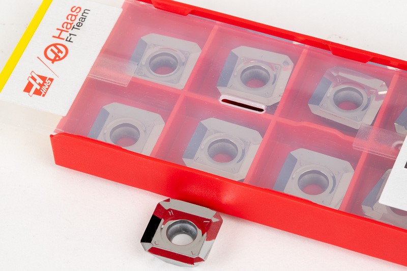

HSPP - High-Speed Face Milling Insert
✓ Designed for high-speed facing operations
✓ Single-sided insert with 4 cutting edges
✓ Large rake angle for faster and easier cutting

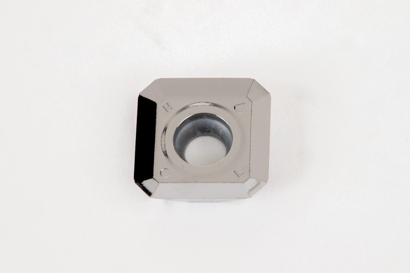

HN25
APPLICABLE WORKPIECE MATERIALS
● N - ALUMINUM / NON-FERROUS
Primary grade for aluminum. Uncoated carbide substrate for fine to medium applications in aluminum and other materials.

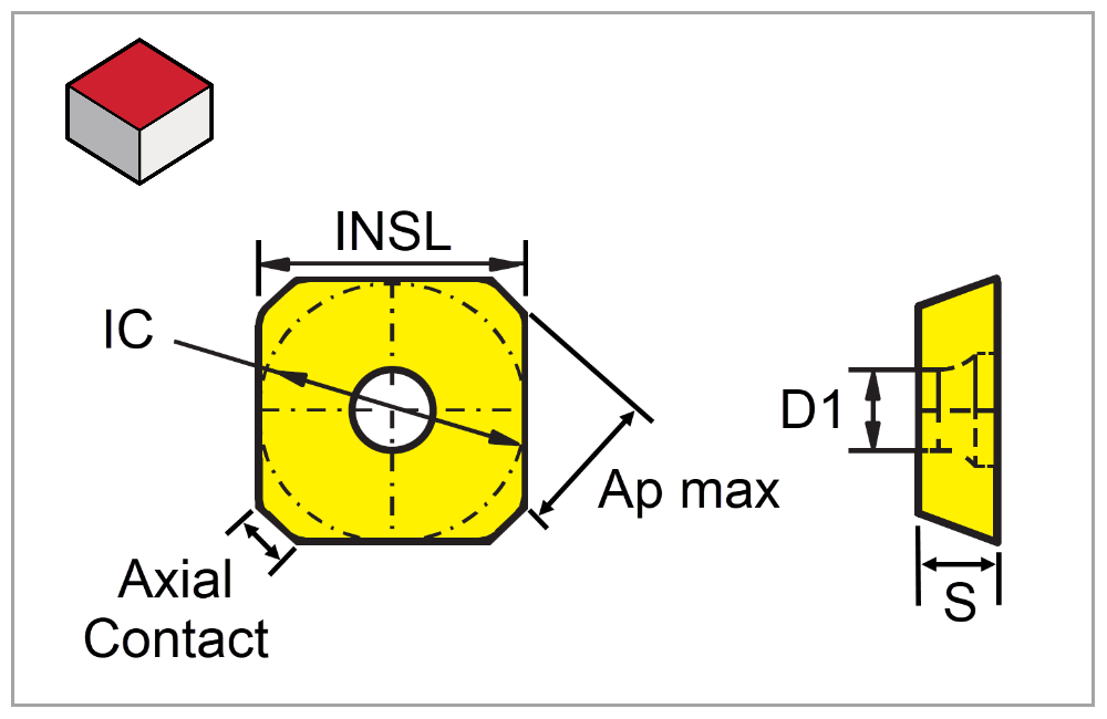

Insert Style Square
Toolpath Type Face Milling
Milling Cutter Series HSPP - Haas Square + / +
Grade HN25
Material Carbide
[IC] Inscribed Circle Diameter 0.528 in \ 13.4 mm
[INSL] Insert Length 0.528 in \ 13.4 mm
[D1] Insert Hole Size 0.161 in \ 4.1 mm
[S] Insert Thickness 0.156 in \ 3.97 mm
[Ap] Max. Cutting Depth 0.236 in \ 6.0 mm
Wiper Edge Length 0.1 in \ 2.55 mm
[AN°] Clearance Angle 20
