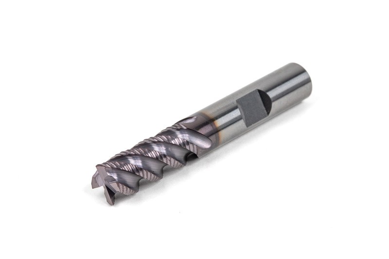

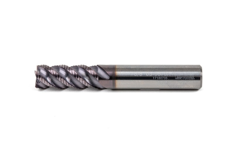

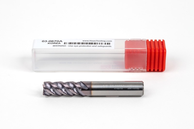

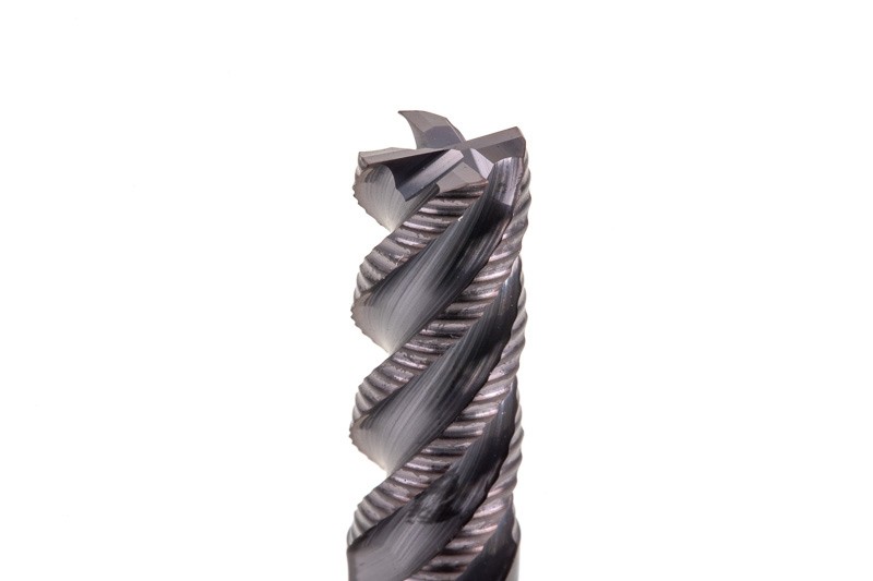

3/8" Dia. Carbide Fine Roughing End Mill, 4 Flute, TiAlN Coated, 3/8" Weldon Shank x 7/8" LOC, 0.006" Chamfer, FPCHH
Part #: 03-0670A
REM 3/8" HI HELIX 4FL CARB TIALN WF
Price: 40.95 ( / unit)
36.97
This FPCHH 4-flute carbide roughing end mill has a 0.375 in \ 3/8" cutting diameter, with a 3/8" weldon shank, 7/8" length of cut (LOC), 0.006" chamfer, and a 2-1/2" overall length. It is TiAlN coated, and made to cut steel, stainless steel, and high temp. alloys. This roughing end mill is designed to center-cut.
ISO Material Chart
Haas Milling Series FPCHH
Primary Workpiece Material S - High Temp Alloys, P - Steel, M - Stainless Steel
Material Carbide
Coating TiAlN
Corner Type Chamfer
Shank Type Weldon
[ØDC] Cutting Diameter 0.375 in \ 3/8"
[ØDMM] Shank Diameter 0.375 in
[LOC] Length Of Cut 0.875 in
[OAL] Overall Length 2.5 in
[NOF] Number of Flutes 4
[CHW\RE] Chamfer \ Radius Size 0.006 in
[FHA°] Helix Angle 45
Cutting Direction Right
Center Cutting Yes
Variable Pitch No
Through Spindle Coolant No
