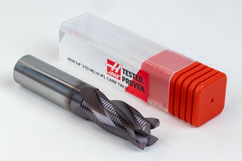

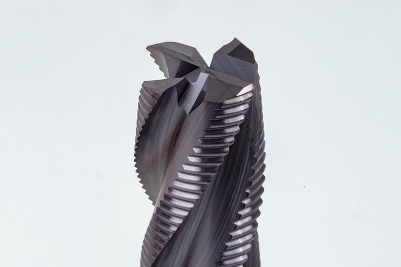

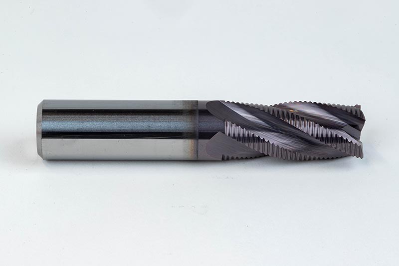

3/4" Dia. Carbide Fine Roughing End Mill, 4 Flute, TiAlN Coated, 3/4" Smooth Shank x 1-5/8" LOC, 0.024" Chamfer, FPCHH
Part #: 03-0678
REM 3/4" STD HELIX 4FL CARB TIALN
Price: 157.95 ( / unit)
110.97
This FPCHH 4-flute carbide roughing end mill has a 0.75 in \ 3/4" cutting diameter, with a 3/4" smooth shank, 1-5/8" length of cut (LOC), 0.024" chamfer, and a 4" overall length. It is TiAlN coated, and made to cut steel, stainless steel, and high temp. alloys. This roughing end mill is designed to center-cut.
ISO Material Chart
Haas Milling Series FPCHH
Primary Workpiece Material S - High Temp Alloys, M - Stainless Steel, P - Steel
Material Carbide
Coating TiAlN
Corner Type Chamfer
Shank Type Smooth
[ØDC] Cutting Diameter 0.75 in \ 3/4"
[ØDMM] Shank Diameter 0.75 in
[LOC] Length Of Cut 1.625 in
[OAL] Overall Length 4.0 in
[NOF] Number of Flutes 4
[CHW\RE] Chamfer \ Radius Size 0.024 in
[FHA°] Helix Angle 30
Cutting Direction Right
Center Cutting Yes
Variable Pitch No
Through Spindle Coolant No
Weight 0.8 lbs \ 0.4 kg
