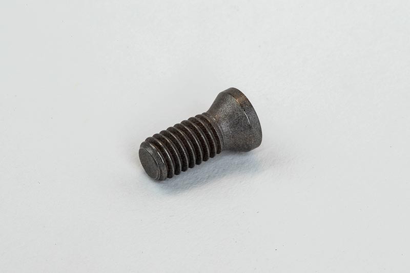

HOP, 2-1/2" Ø Shell Mill, 3/4" Pilot Bore x 45° Lead Angle, 5 Flute, Positive/Positive Geometry
Part #: 01-0002
HOP-45-2.5-.75-4-5 SHELL MILL
Price: 138.95 ( / unit)
104.97
This Haas Octagon Positive (HOP) medium-pitch shell mill is a great, cost-effective cutter for a wide range of materials, specifically designed for face milling. It has a 2.5 in \ 2-1/2" cutting diameter, and a 3/4" pilot bore, with a 45-degree cutting edge. The positive axial, positive radial-raked cutter body takes 5 octagon cutting inserts. The screw-clamp inserts have 8 cutting edges, and are available in grades for steel, stainless steel, cast iron, and aluminum/non-ferrous materials. Inserts sold separately.
[ØDC] Cutting Diameter 2.5 in \ 2-1/2"
Milling Cutter Series HOP - Haas Octagon +
Toolpath Type Face Milling
[ØDCX] Max Cutting Diameter 2.856 in
[°] Lead Angle 45 Degree
[Z] Number of Cutting Teeth 5
[Ød] Arbor Hole Diameter 0.75 in
[a] Keyway Width 0.313 in
[Ap] Max. Cutting Depth 0.138 in
[OAL] Overall Length 1.75 in
Maximum RPM 5000
Torque of Insert Screw 340 Ncm
Coupling Style A
Through Tool Coolant No
Weight 1.8 lbs \ 0.8 kg
