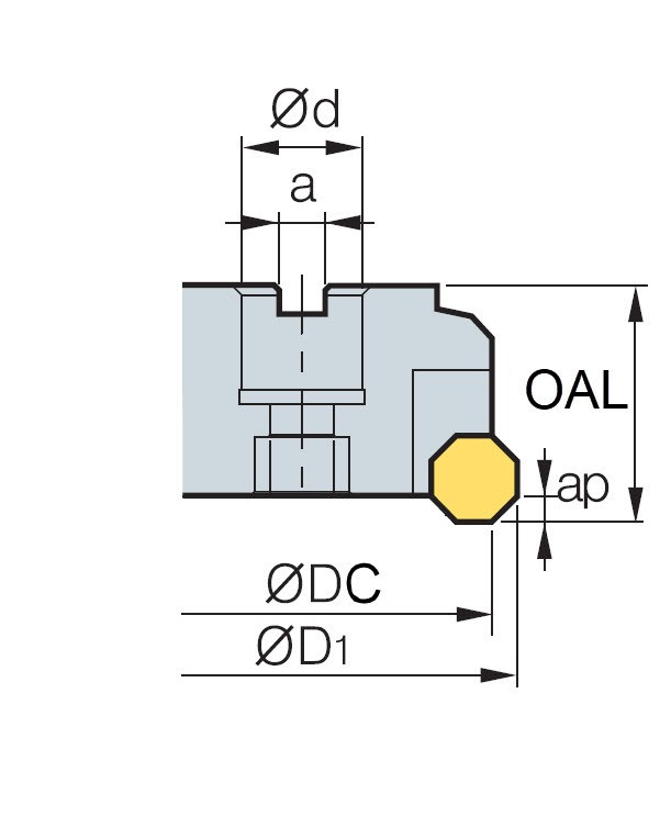

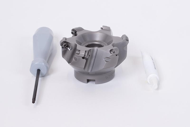

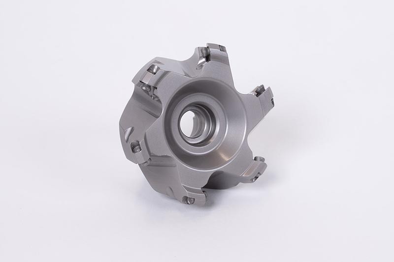

This Haas Octagon Positive (HOP) medium-pitch shell mill is a great, cost-effective cutter for a wide range of materials, specifically designed for face milling. It has a 3.0 in \ 3" cutting diameter, and a 1" pilot bore, with a 45-degree cutting edge. The positive axial, positive radial-raked cutter body takes 6 octagon cutting inserts. The screw-clamp inserts have 8 cutting edges, and are available in grades for steel, stainless steel, cast iron, and aluminum/non-ferrous materials. Inserts sold separately.
[ØDC] Cutting Diameter 3.0 in \ 3"
Milling Cutter Series HOP - Haas Octagon +
Toolpath Type Face Milling
[ØDCX] Max Cutting Diameter 3.356 in
[°] Lead Angle 45 Degree
[Z] Number of Cutting Teeth 6
[Ød] Arbor Hole Diameter 1.0 in
[a] Keyway Width 0.375 in
[Ap] Max. Cutting Depth 0.138 in
[OAL] Overall Length 2.0 in
Maximum RPM 4100
Torque of Insert Screw 340 Ncm
Coupling Style A
Through Tool Coolant No
Weight 2.7 lbs \ 1.2 kg
