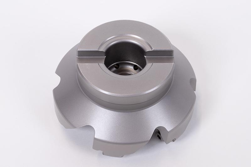

This Haas Square Negative Positive (HSNP) medium-pitch shell mill is an economical cutter that produces lower cutting forces and improved surface finishes due to its balanced geometry, as well as its thick, wiper-edge inserts. It is a superior choice for harder materials, specfically when face milling. It has a 3.0 in \ 3" cutting diameter, and a 1" pilot bore, with a 45-degree cutting edge. The negative axial, positive radial-raked cutter body takes 6 square cutting inserts. The screw-clamp inserts have 8 cutting edges, and are available in grades for steel, stainless steel, and cast iron. This cutter body is through-tool coolant (TSC) capable, when used in conjunction with a coolant-through arbor screw. Inserts and coolant-through arbor screw sold separately.

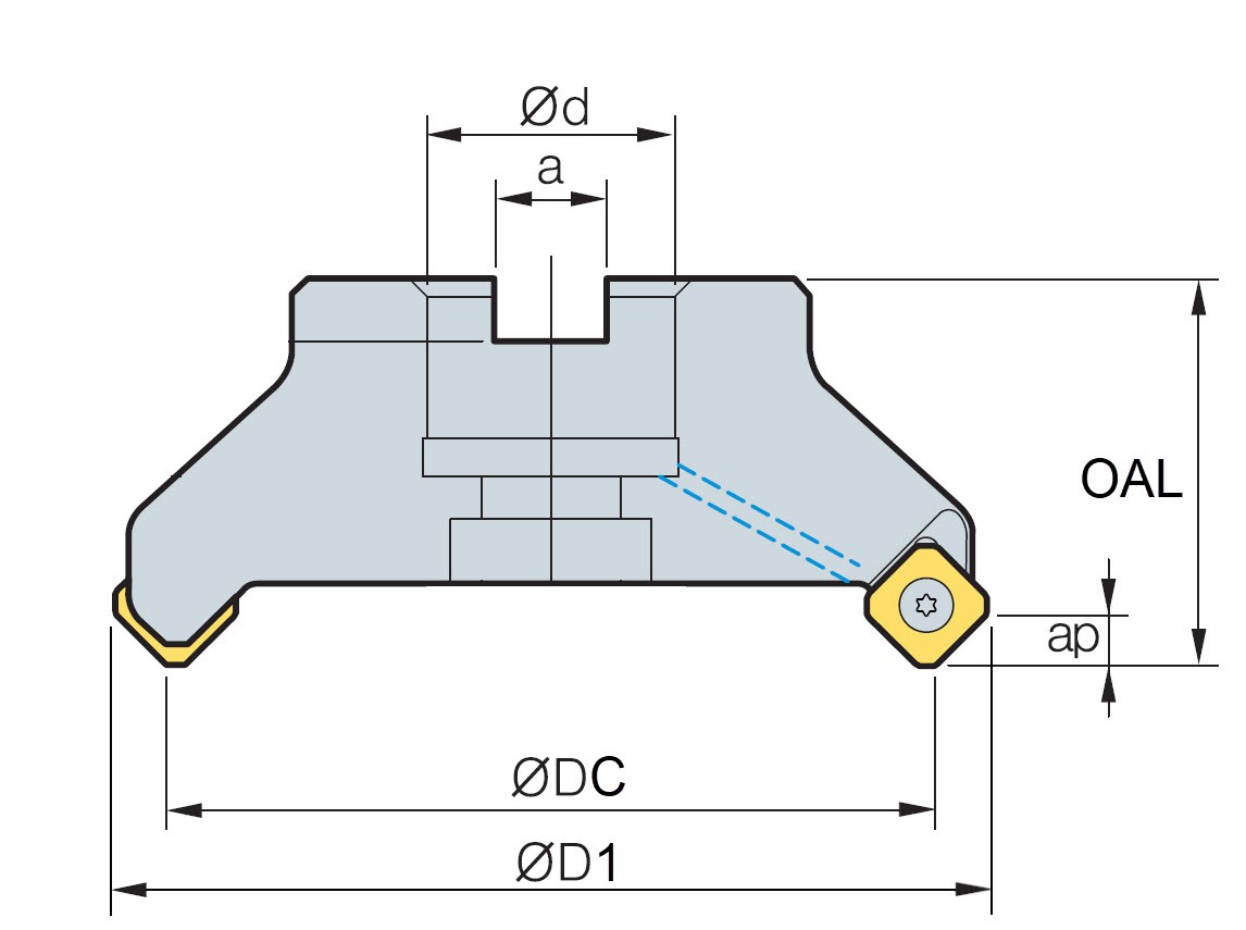

[ØDC] Cutting Diameter 3.0 in \ 3"
Milling Cutter Series HSNP - Haas Square - / +
Toolpath Type Face Milling
[ØDCX] Max Cutting Diameter 3.602 in
[°] Lead Angle 45 Degree
[Z] Number of Cutting Teeth 6
[Ød] Arbor Hole Diameter 1.0 in
[a] Keyway Width 0.375 in
[Ap] Max. Cutting Depth 0.275 in
[OAL] Overall Length 2.0 in
Maximum RPM 4100
Torque of Insert Screw 670 Ncm
Coupling Style A
Through Tool Coolant Yes
Weight 3.2 lbs \ 1.5 kg
