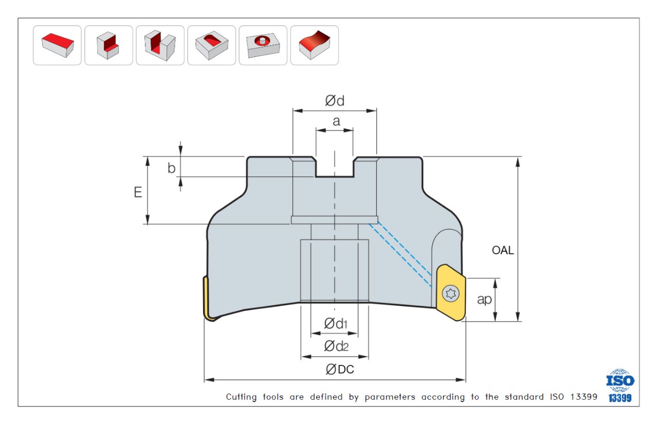

[ØDC] Cutting Diameter 50.0 mm
Milling Cutter Series HPAL - Haas HP Aluminum
Toolpath Type Face Milling, Shoulder Milling, Slotting, Ramping, Helical Milling, Copy Milling
[°] Lead Angle 90 Degree
[Z] Number of Cutting Teeth 4
[Ød2] Diameter 18.0 mm
[Ød] Arbor Hole Diameter 22.0 mm
[E] Arbor Hole Depth 21.0 mm
[a] Keyway Width 10.4 mm
[b] Keyway Depth 6.3 mm
[Ap] Max. Cutting Depth 17.0 mm
[OAL] Overall Length 50.0 mm
Maximum RPM 20000
Torque of Insert Screw 300 Ncm
Coupling Style A
Through Tool Coolant Yes
Weight 0.7 lbs \ 0.3 kg
