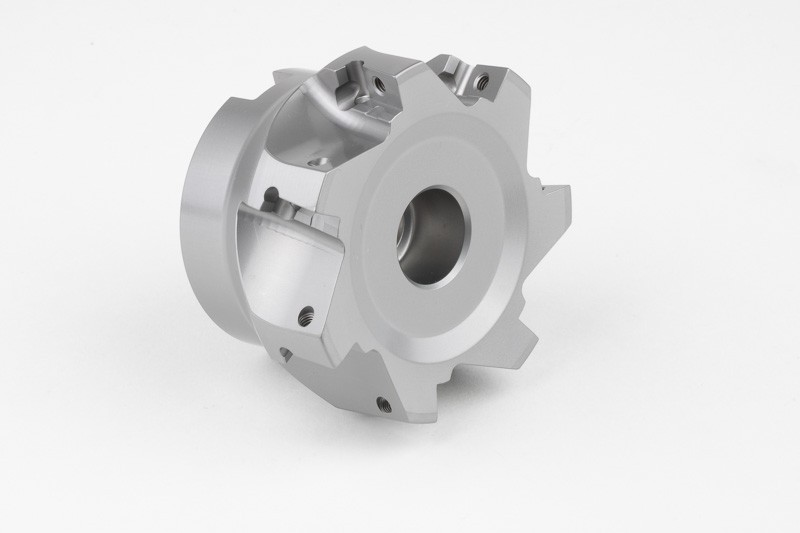

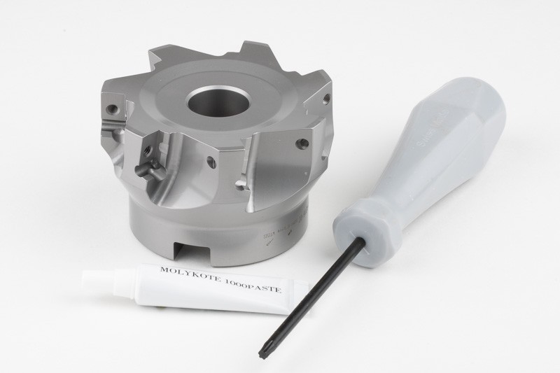

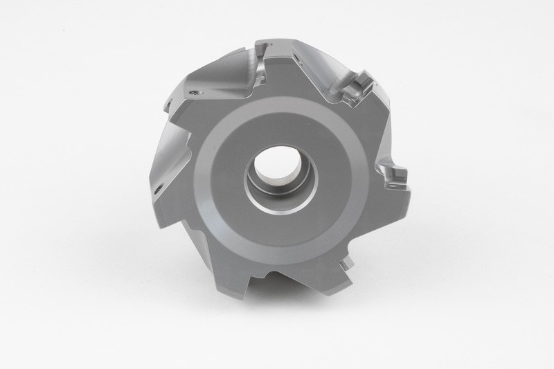

This Haas Parallelogram Positive/Negative (HAPN) medium-pitch shell mill is characterized by its axially positive, soft-cutting insert geometry and wide chip pockets, which respectively, improve machinability and chip evacuation at large cutting depths, particularly when face milling and shoulder milling. It has a 80mm cutting diameter, and a 27mm pilot bore, with a 90-degree cutting edge. The positive axial, negative radial-raked cutter body takes 7 parallelogram cutting inserts. The screw-clamp inserts have 2 cutting edges, and are available in grades for steel, stainless steel, and aluminum/non-ferrous materials. Inserts sold separately.
[ØDC] Cutting Diameter 80.0 mm
Milling Cutter Series HAPN – Haas Parallelogram +/-
Toolpath Type Face Milling, Shoulder Milling
[°] Lead Angle 90 Degree
[Z] Number of Cutting Teeth 7
[Ød] Arbor Hole Diameter 27.0 mm
[a] Keyway Width 12.4 mm
[Ap] Max. Cutting Depth 15.5 mm
[OAL] Overall Length 50.0 mm
Maximum RPM 14500
Coupling Style A
Through Tool Coolant No
Weight 2.4 lbs \ 1.1 kg
