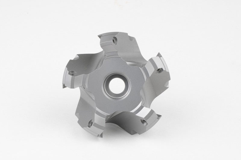

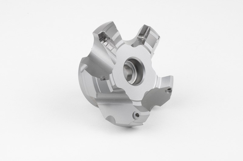

This Haas Square Positive Positive (HSPP) medium-pitch shell mill is an excellent multi-purpose cutter for applications that require high material removal rates while still maintaining good surface finishes. The large spaces between each cutting edge encourage excellent chip evacuation, and the wiper-edge inserts improve overall surface finish when face milling. It has a 63mm cutting diameter, and a 22mm pilot bore, with a 45-degree cutting edge. The positive axial, positive radial-raked cutter body takes 5 square cutting inserts. The screw-clamp inserts have 4 cutting edges, and are available in grades for steel, stainless steel, and aluminum/non-ferrous materials. Inserts sold separately.
[ØDC] Cutting Diameter 63.0 mm
Milling Cutter Series HSPP - Haas Square + / +
Toolpath Type Face Milling
[ØDCX] Max Cutting Diameter 74.0 mm
[°] Lead Angle 45 Degree
[Z] Number of Cutting Teeth 5
[Ød] Arbor Hole Diameter 22.0 mm
[a] Keyway Width 10.4 mm
[Ap] Max. Cutting Depth 6.0 mm
[OAL] Overall Length 40.0 mm
Maximum RPM 14000
Coupling Style A
Through Tool Coolant No
Weight 1.1 lbs \ 0.5 kg
