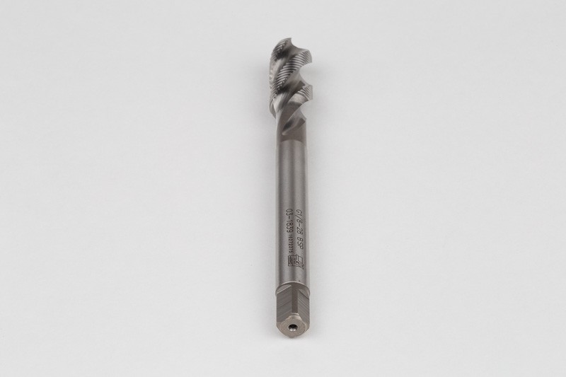

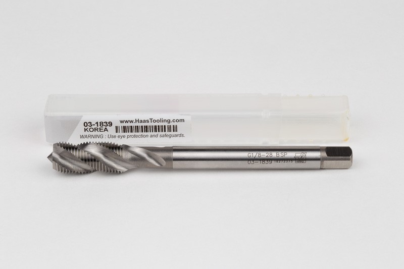

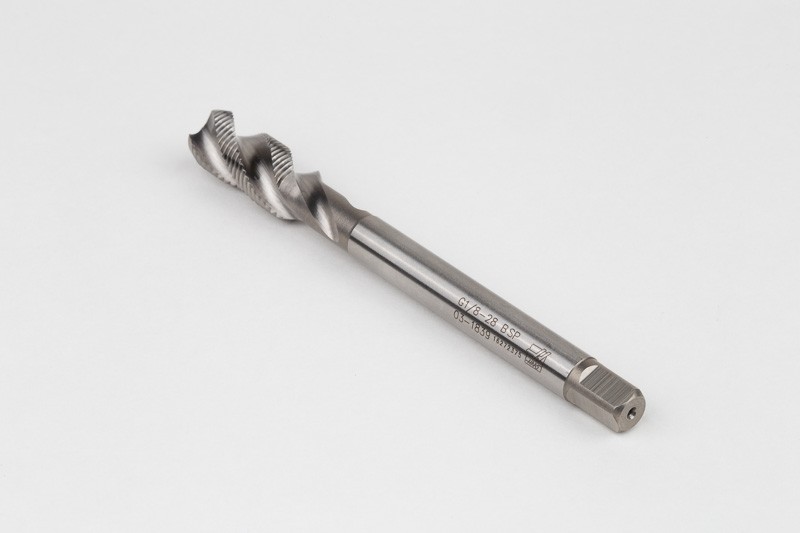

1/8"-28 G (BSPP) Straight HSS-E Pipe Tap, 7mm Shank x 20mm Thread Length, 3 Flute, Uncoated
Part #: 03-1839
G1/8-28 BSP WHITWORTH PIPE TAPS
Price: 20.95 ( / unit)
Price: 298.95 ( / unit)
Price: 88.95 ( / unit)
Price: 11.95 ( / unit)
Price: 53.95 ( / unit)
Price: 125.95 ( / unit)
14.97
ISO Material Chart
Primary Workpiece Material N - Aluminum, K - Cast Iron, P - Steel
Material HSS-E
Coating Uncoated
Thread Series G (BSPP) - G-Series
Thread Size 1/8"-28
Tap Type Pipe Tap
Shank Type Square
[TPI] Threads per Inch 28 tpi
Tap Drill Diameter 0.3465 in
[ØDC] Cutting Diameter 0.125 in
[ØDMM] Shank Diameter 0.2756 in
[L2] Chamfer Length 2P-3P
[L1] Thread Length 0.787 in
[LU] Usable Length 1.417 in
[OAL] Overall Length 3.543 in
[SS] Square Size 0.2165 in
[NOF] Number of Flutes 3
[FHA°] Helix Angle 40
Length / Diameter 2.5 X D
Through Spindle Coolant Yes
