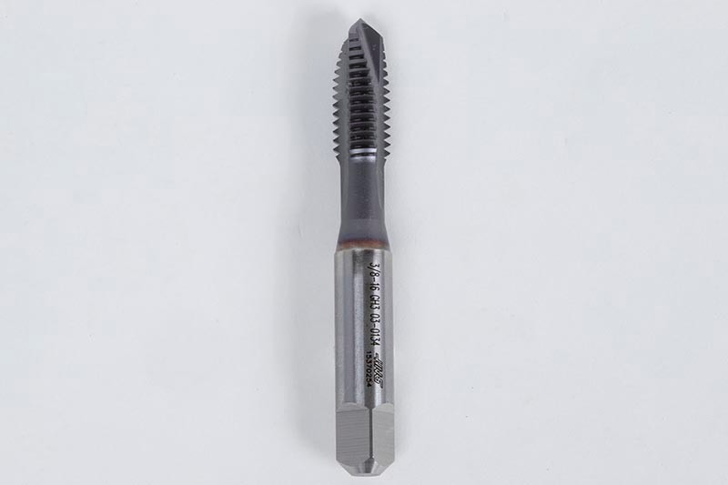

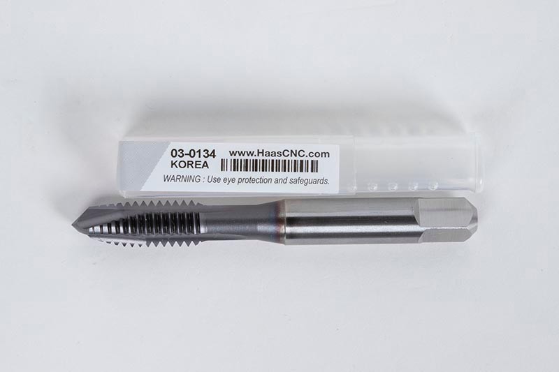

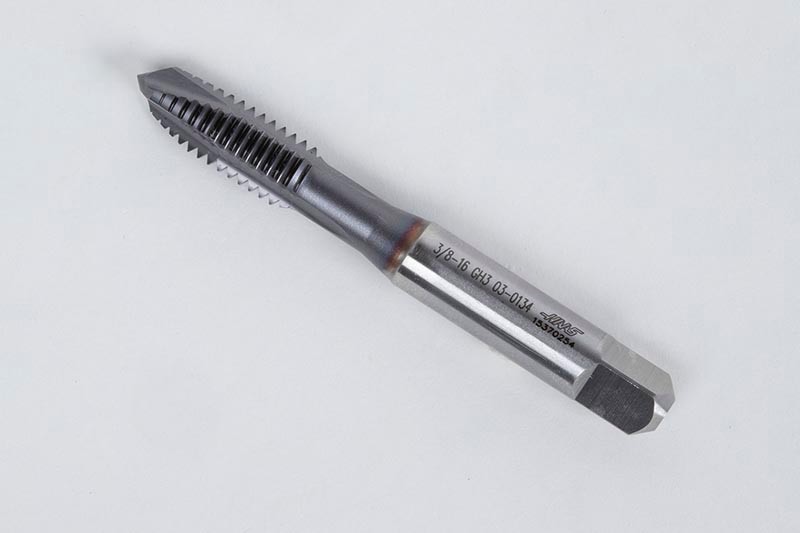

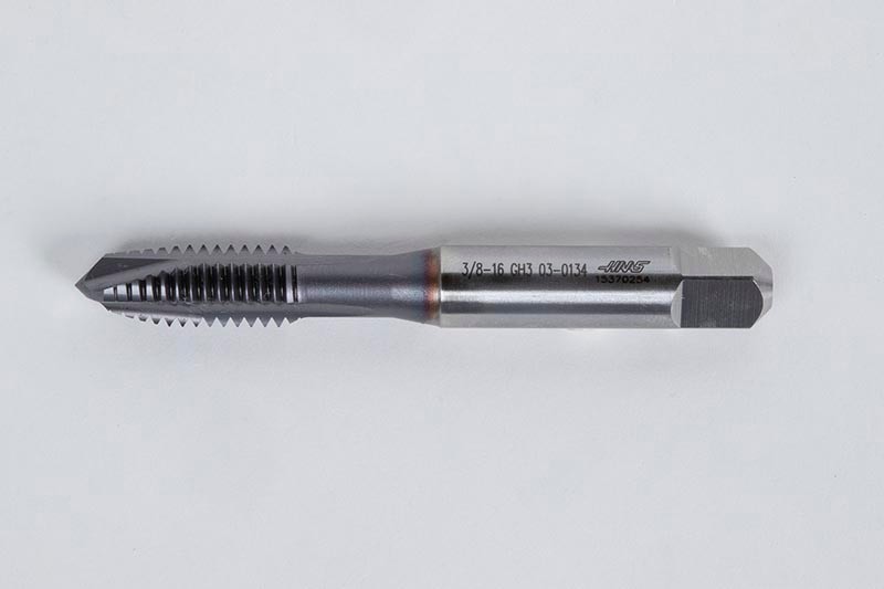

3/8"-16 UNC HSS-E Spiral Point Tap, 0.381" Shank x 0.748" Thread Length, 3XD, Plug, 3 Flute, GH3, TiCN Coated
Part #: 03-0134
3/8-16 SP PT MULTIPLE MATERIAL TAP
Price: 19.95 ( / unit)
11.97
ISO MATERIAL CHART
Thread Size 3/8"-16
Primary Workpiece Material K - Cast Iron, M - Stainless Steel, N - Aluminum, P - Steel
Tap Type Spiral Point
Chamfer Type Plug
Shank Type Square
Material HSS-E
Coating TiCN
[TPI] Threads per Inch 16 tpi
Tap Drill Diameter 0.315 in
[ØDC] Cutting Diameter 0.375 in
[ØDMM] Shank Diameter 0.381 in
[L2] Chamfer Length 4P - 5P
[L1] Thread Length 0.748 in
[LU] Usable Length 1.252 in
[OAL] Overall Length 2.937 in
[SS] Square Size 0.286 in
[NOF] Number of Flutes 3
[FHA°] Helix Angle 0
Length / Diameter 3 X D
Thread Class GH3
Through Spindle Coolant No
