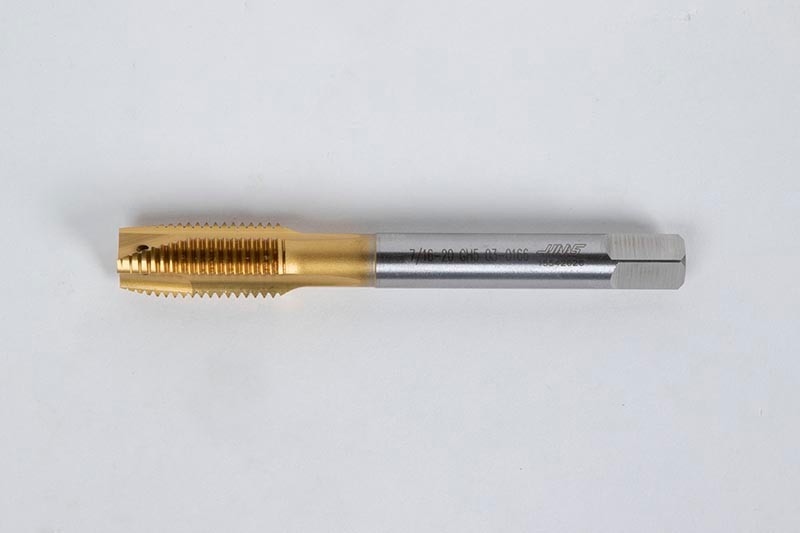

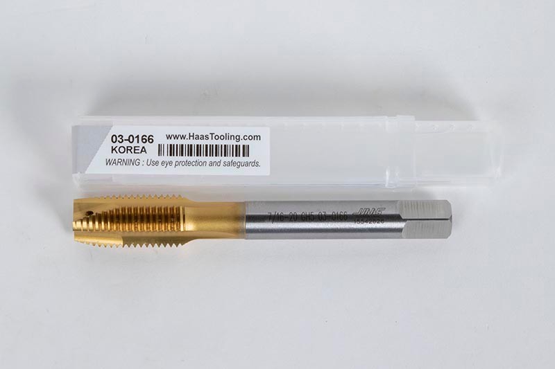

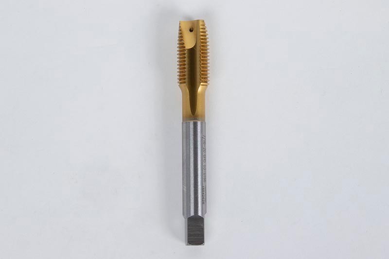

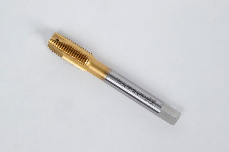

7/16"-20 UNF HSS-E Spiral Point Tap, 0.323" Shank x 0.866" Thread Length, 3XD, Plug, 3 Flute, GH5, TiN Coated
Part #: 03-0166
7/16-20 SP PT TSC MULTIPLE MATERIAL TAP
Price: 30.95 ( / unit)
18.97
ISO MATERIAL CHART
Thread Series UNF - Unified Natl. Fine
Thread Size 7/16"-20
Primary Workpiece Material N - Aluminum, K - Cast Iron, P - Steel, M - Stainless Steel
Tap Type Spiral Point
Chamfer Type Plug
Shank Type Square
Material HSS-E
Coating TiN
[TPI] Threads per Inch 20 tpi
Tap Drill Diameter 0.39 in
[ØDC] Cutting Diameter 0.4375 in
[ØDMM] Shank Diameter 0.323 in
[L2] Chamfer Length 4P - 5P
[L1] Thread Length 0.866 in
[LU] Usable Length 1.437 in
[OAL] Overall Length 3.158 in
[SS] Square Size 0.242 in
[NOF] Number of Flutes 3
[FHA°] Helix Angle 0
Length / Diameter 3 X D
Thread Class GH5
Through Spindle Coolant Yes
