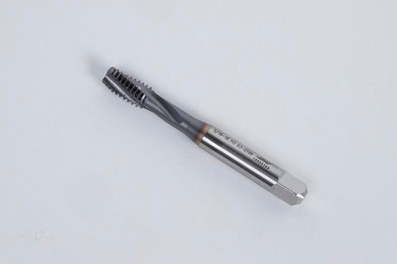

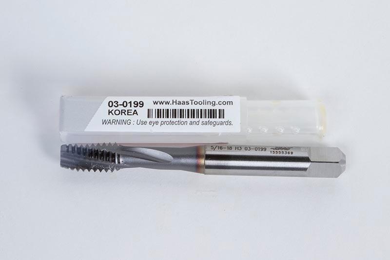

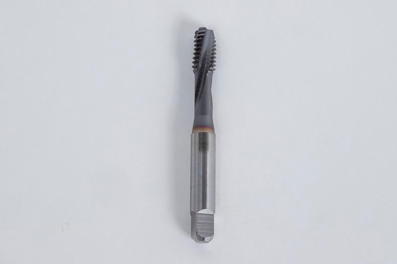

5/16"-18 UNC HSS-E Spiral Flute Tap, 0.318" Shank x 0.472" Thread Length, 2.5XD, Mod. Bottoming, 3 Flute, H3, TiCN Coated
Part #: 03-0199
5/16-18 SP FL TI & NI ALLOY TAP
Price: 22.95 ( / unit)
13.97
ISO MATERIAL CHART
Thread Size 5/16"-18
Primary Workpiece Material S - High Temp Alloys
Secondary Workpiece Material P - Steel, H - Hardened Materials
Tap Type Spiral Flute
Shank Type Square
Material HSS-E
Coating TiCN
[TPI] Threads per Inch 18 tpi
Tap Drill Diameter 0.26 in
[ØDC] Cutting Diameter 0.3125 in
[ØDMM] Shank Diameter 0.318 in
[L2] Chamfer Length 2P - 3P
[L1] Thread Length 0.472 in
[LU] Usable Length 1.126 in
[OAL] Overall Length 2.721 in
[SS] Square Size 0.238 in
[NOF] Number of Flutes 3
[FHA°] Helix Angle 15
Length / Diameter 2.5 X D
Thread Class H3
