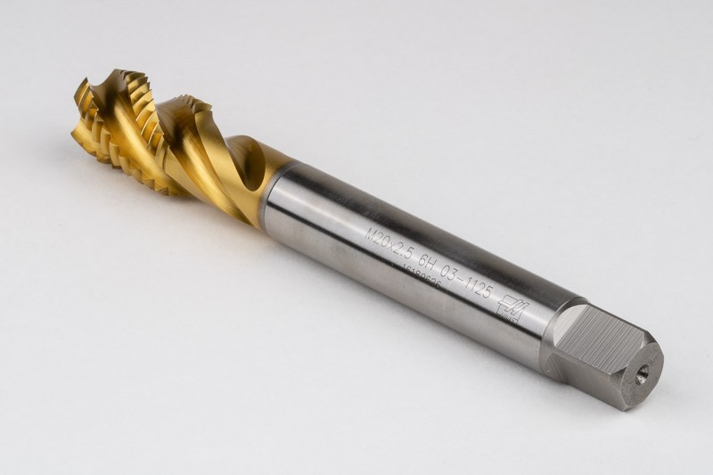

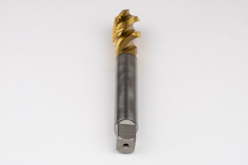

M20x2.5 M HSS-E Spiral Flute Tap, 16mm Shank x 25mm Thread Length, 2.5XD, Mod. Bottoming, 4 Flute, 6H, TiN Coated
Part #: 03-1125
M20 X 2.5 SP FL MULTIPLE MATERIAL TAP
Price: 53.95 ( / unit)
Price: 798.95 ( / unit)
Price: 237.95 ( / unit)
Price: 31.95 ( / unit)
Price: 143.95 ( / unit)
Price: 335.95 ( / unit)
45.97
  • SPEEDS & FEEDS (INCH)
  • Speeds & Feeds (METRIC)
ISO MATERIAL CHART
Thread Series M - Metric
Thread Size M20x2.5
Primary Workpiece Material K - Cast Iron, N - Aluminum, P - Steel, M - Stainless Steel
Tap Type Spiral Flute
Shank Type Square
Material HSS-E
Coating TiN
[TP] Thread Pitch 2.5 mm
Tap Drill Diameter 17.5 mm
[ØDC] Cutting Diameter 20.0 mm
[ØDMM] Shank Diameter 16.0 mm
[L2] Chamfer Length 2P - 3P
[L1] Thread Length 25.0 mm
[LU] Usable Length 54.0 mm
[OAL] Overall Length 140.0 mm
[SS] Square Size 12.0 mm
[NOF] Number of Flutes 4
[FHA°] Helix Angle 40
Length / Diameter 2.5 X D
Thread Class 6H
Through Spindle Coolant No
Weight 0.5 lbs \ 0.2 kg
