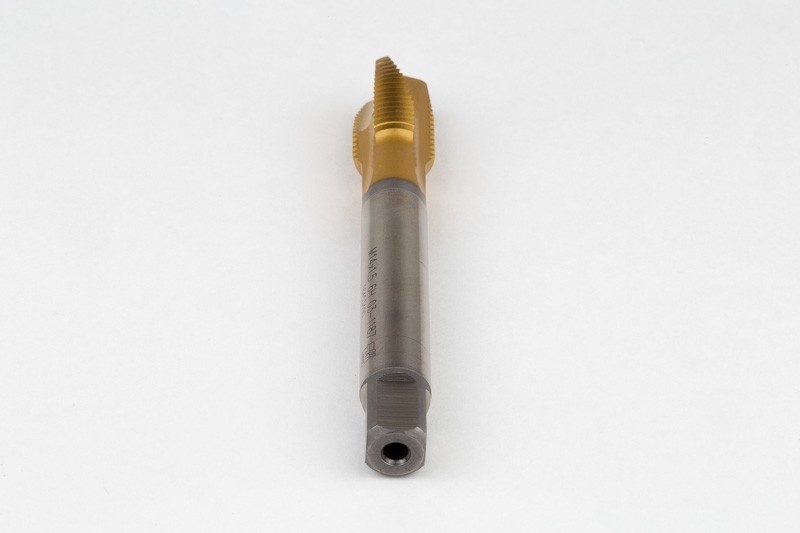

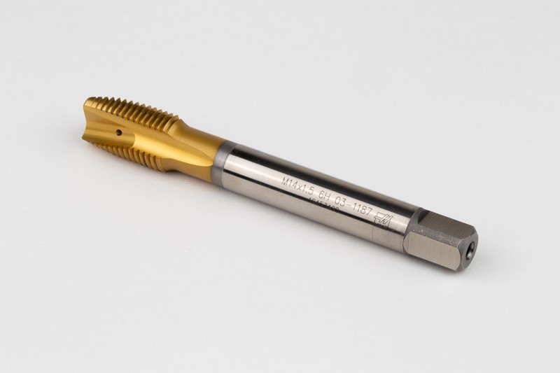

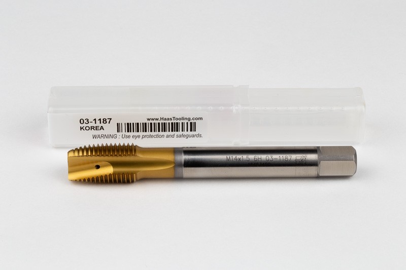

M14x1.5 MF HSS-E Spiral Point Tap, 11mm Shank x 22mm Thread Length, 3XD, Plug, 3 Flute, 6H, TiN Coated
Part #: 03-1187
M14 X 1.5 SP PT TSC MULTIPLE MATERIAL TA
Price: 39.95 ( / unit)
Price: 523.95 ( / unit)
Price: 155.95 ( / unit)
Price: 20.95 ( / unit)
Price: 94.95 ( / unit)
Price: 219.95 ( / unit)
27.97
  • SPEEDS & FEEDS (INCH)
  • Speeds & Feeds (METRIC)
ISO MATERIAL CHART
Thread Series MF - Metric Fine
Thread Size M14x1.5
Primary Workpiece Material M - Stainless Steel, N - Aluminum, K - Cast Iron, P - Steel
Tap Type Spiral Point
Chamfer Type Plug
Shank Type Square
Material HSS-E
Coating TiN
[TP] Thread Pitch 1.5 mm
Tap Drill Diameter 12.5 mm
[ØDC] Cutting Diameter 14.0 mm
[ØDMM] Shank Diameter 11.0 mm
[L2] Chamfer Length 4P - 5P
[L1] Thread Length 22.0 mm
[LU] Usable Length 40.0 mm
[OAL] Overall Length 100.0 mm
[SS] Square Size 9.0 mm
[NOF] Number of Flutes 3
[FHA°] Helix Angle 0
Length / Diameter 3 X D
Thread Class 6H
Through Spindle Coolant Yes
