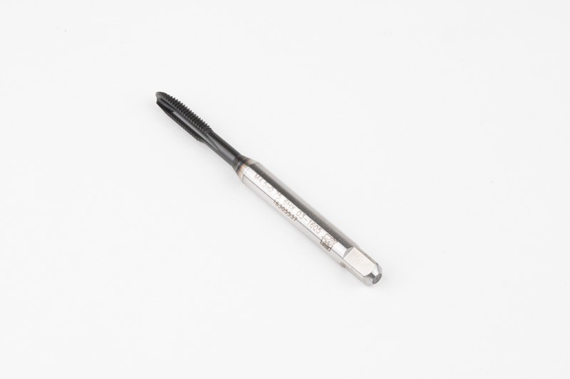

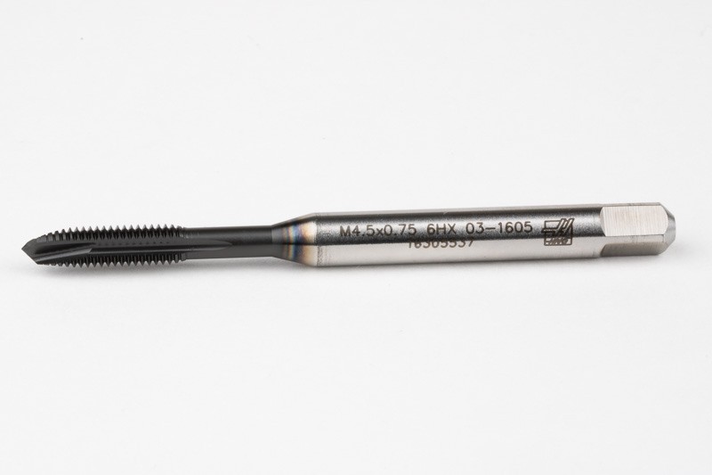

Thread Series M - Metric
Thread Size M4.5x0.75
Primary Workpiece Material M - Stainless Steel, P - Steel
Tap Type Spiral Point
Chamfer Type Plug
Shank Type Square
Material HSS-E
Coating Hardslick
[TP] Thread Pitch 0.75 mm
Tap Drill Diameter 3.7 mm
[ØDC] Cutting Diameter 4.5 mm
[ØDMM] Shank Diameter 6.0 mm
[L2] Chamfer Length 4P - 5P
[L1] Thread Length 14.0 mm
[LU] Usable Length 25.0 mm
[OAL] Overall Length 70.0 mm
[SS] Square Size 4.9 mm
[NOF] Number of Flutes 3
[FHA°] Helix Angle 0
Length / Diameter 3 X D
Thread Class 6HX
Through Spindle Coolant No
