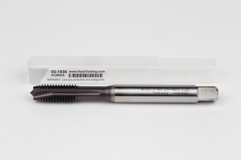

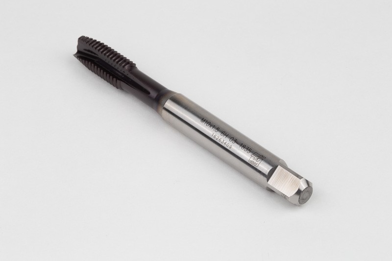

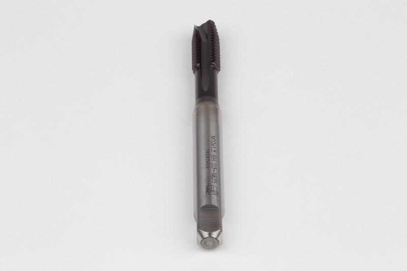

M10x1.5 M HSS-PM Spiral Point Tap, 10mm Shank x 22mm Thread Length, 3XD, Plug, 3 Flute, 6H, TiAlN Coated
Part #: 03-1835
M10 X 1.5 SP PT TI & NI ALLOY TAP
Price: 20.95 ( / unit)
Price: 298.95 ( / unit)
Price: 88.95 ( / unit)
Price: 11.95 ( / unit)
Price: 53.95 ( / unit)
Price: 125.95 ( / unit)
14.97
  • SPEEDS & FEEDS (INCH)
  • SPEEDS & FEEDS (METRIC)
ISO MATERIAL CHART
Thread Series M - Metric
Thread Size M10x1.5
Primary Workpiece Material P - Steel, S - High Temp Alloys
Secondary Workpiece Material H - Hardened Materials
Tap Type Spiral Point
Chamfer Type Plug
Shank Type Square
Material HSS-PM
Coating TiAlN
[TP] Thread Pitch 1.5 mm
Tap Drill Diameter 8.5 mm
[ØDC] Cutting Diameter 10.0 mm
[ØDMM] Shank Diameter 10.0 mm
[L2] Chamfer Length 4P - 5P
[L1] Thread Length 22.0 mm
[LU] Usable Length 39.0 mm
[OAL] Overall Length 100.0 mm
[SS] Square Size 8.0 mm
[NOF] Number of Flutes 3
[FHA°] Helix Angle 0
Length / Diameter 3 X D
Thread Class 6H
Through Spindle Coolant No
