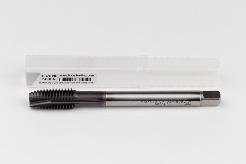

M12x1.75 M HSS-PM Spiral Point Tap, 9mm Shank x 24mm Thread Length, 3XD, Plug, 3 Flute, 6H, TiAlN Coated
Part #: 03-1836
M12 X 1.75 SP PT TI & NI ALLOY TAP
Price: 29.95 ( / unit)
Price: 398.95 ( / unit)
Price: 118.95 ( / unit)
Price: 15.95 ( / unit)
Price: 71.95 ( / unit)
Price: 167.95 ( / unit)
20.97
  • SPEEDS & FEEDS (INCH)
  • SPEEDS & FEEDS (METRIC)
ISO MATERIAL CHART
Thread Series M - Metric
Thread Size M12x1.75
Primary Workpiece Material P - Steel, S - High Temp Alloys
Secondary Workpiece Material H - Hardened Materials
Tap Type Spiral Point
Chamfer Type Plug
Shank Type Square
Material HSS-PM
Coating TiAlN
[TP] Thread Pitch 1.75 mm
Tap Drill Diameter 10.2 mm
[ØDC] Cutting Diameter 12.0 mm
[ØDMM] Shank Diameter 9.0 mm
[L2] Chamfer Length 4P - 5P
[L1] Thread Length 24.0 mm
[LU] Usable Length 44.0 mm
[OAL] Overall Length 110.0 mm
[SS] Square Size 7.0 mm
[NOF] Number of Flutes 3
[FHA°] Helix Angle 0
Length / Diameter 3 X D
Thread Class 6H
Through Spindle Coolant No
