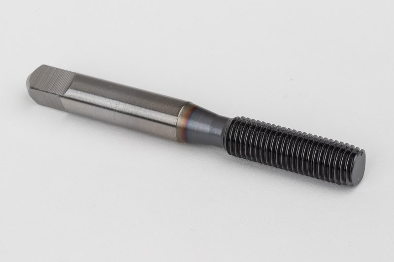

5/16"-24 UNF HSS-PM Roll Tap, 0.318" Shank x 0.929" Thread Length, 3XD, Mod. Bottoming, GH7, TiCN Coated
Part #: 03-1897
5/16-24 ROLL TAP BTM 2B T-15
Price: 46.95 ( / unit)
28.97
  • Roll Tap Size Chart
ISO MATERIAL CHART
Thread Series UNF - Unified Natl. Fine
Thread Size 5/16"-24
Primary Workpiece Material P - Steel, N - Aluminum, M - Stainless Steel
Tap Type Roll Tap
Shank Type Square
Material HSS-PM
Coating TiCN
[TPI] Threads per Inch 24 tpi
Tap Drill Diameter 0.293 in
[ØDC] Cutting Diameter 0.3125 in
[ØDMM] Shank Diameter 0.318 in
[L2] Chamfer Length 2P - 3P
[L1] Thread Length 0.929 in
[LU] Usable Length 1.126 in
[OAL] Overall Length 2.721 in
[SS] Square Size 0.238 in
[FHA°] Helix Angle 0
Length / Diameter 3 X D
Thread Class GH7
Through Spindle Coolant No
