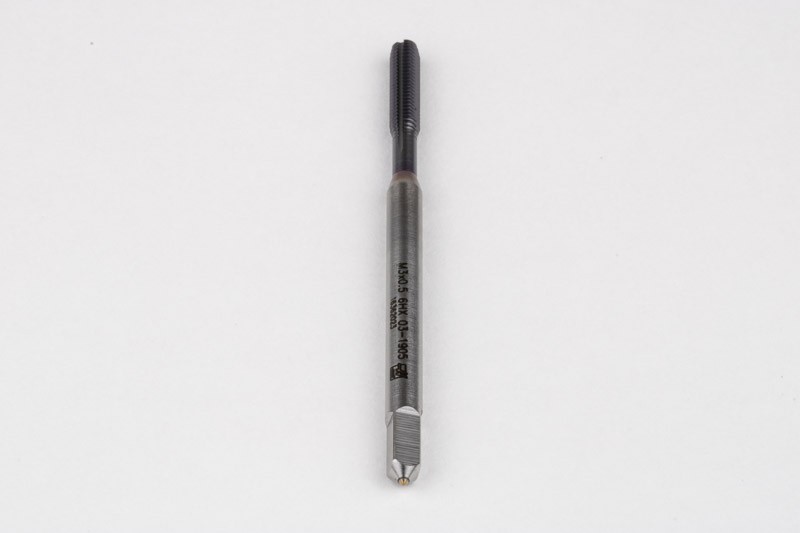

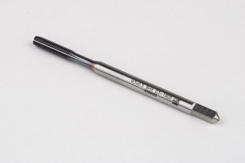

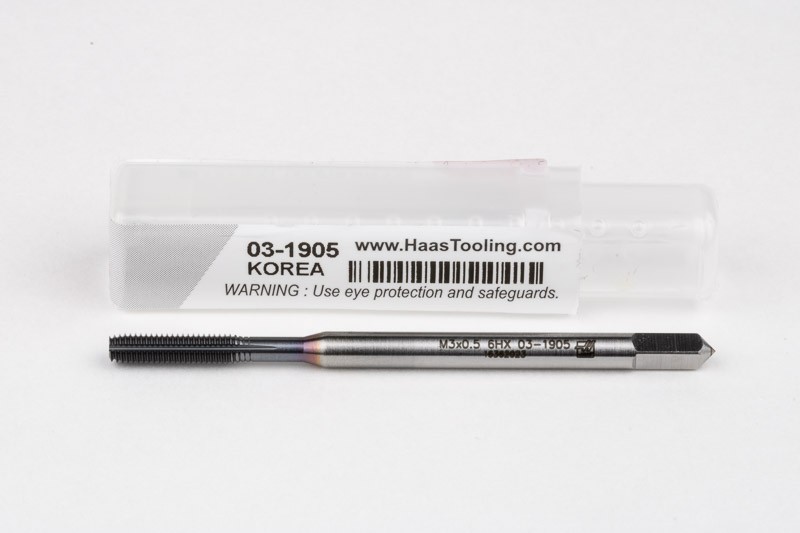

M3x0.5 M HSS-PM Roll Tap, 3.5mm Shank x 11mm Thread Length, 3XD, Mod. Bottoming, 6HX, TiCN Coated
Part #: 03-1905
M3 X 0.5 ROLL TAP BTM 6HX T-15
Price: 26.95 ( / unit)
Price: 398.95 ( / unit)
Price: 118.95 ( / unit)
Price: 15.95 ( / unit)
Price: 71.95 ( / unit)
Price: 167.95 ( / unit)
18.97
  • Roll Tap Size Chart
ISO MATERIAL CHART
Thread Series M - Metric
Thread Size M3x0.5
Primary Workpiece Material P - Steel, M - Stainless Steel, N - Aluminum
Tap Type Roll Tap
Shank Type Square
Material HSS-PM
Coating TiCN
[TP] Thread Pitch 0.5 mm
Tap Drill Diameter 2.8 mm
[ØDC] Cutting Diameter 3.0 mm
[ØDMM] Shank Diameter 3.5 mm
[L2] Chamfer Length 2P - 3P
[L1] Thread Length 11.0 mm
[LU] Usable Length 18.0 mm
[OAL] Overall Length 56.0 mm
[SS] Square Size 2.7 mm
[FHA°] Helix Angle 0
Length / Diameter 3 X D
Thread Class 6HX
Through Spindle Coolant No
