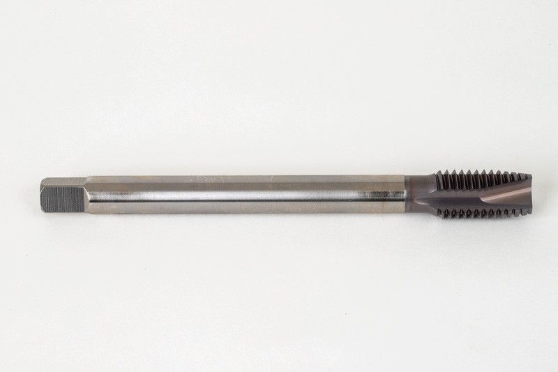

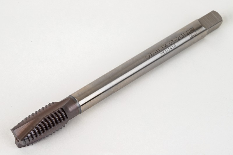

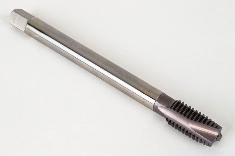

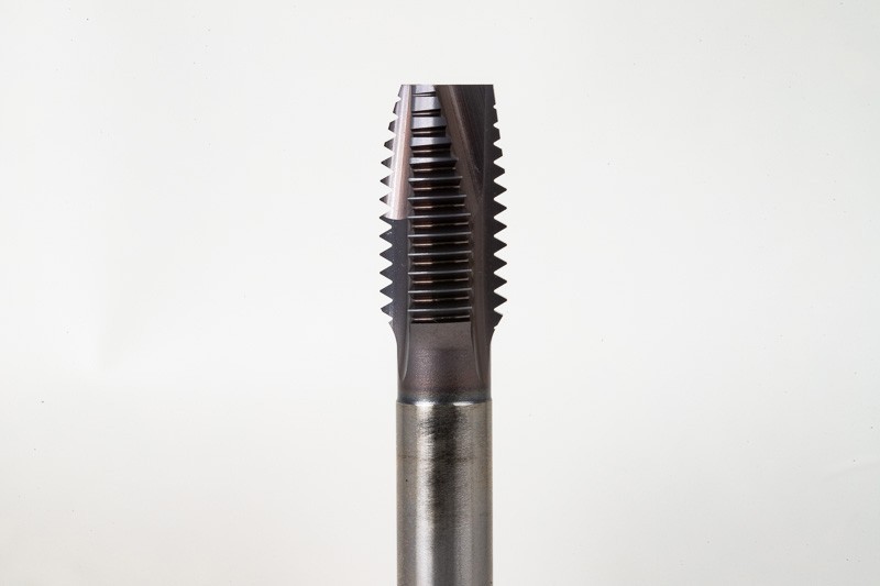

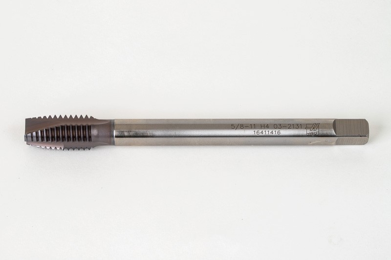

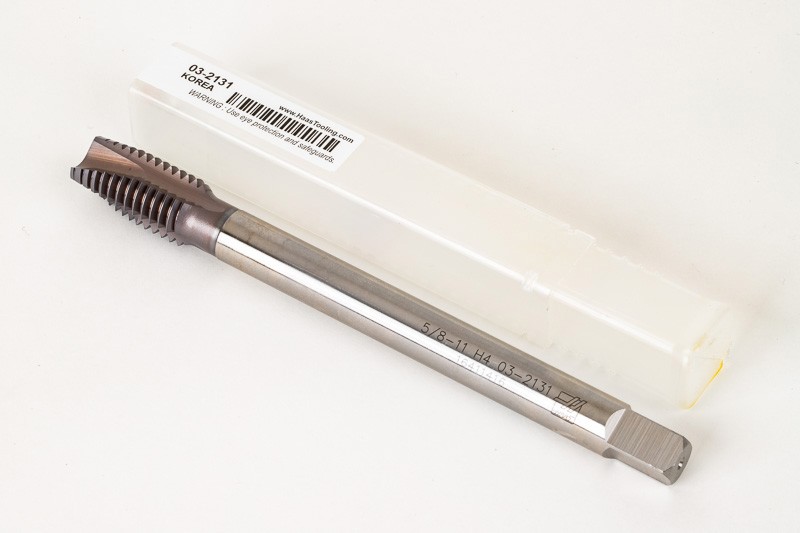

5/8"-11 UNC HSS-E Spiral Point Ext. Tap, 0.48" Shank x 1.091" Thread Length, 3XD, Plug, 3 Flute, H4, TiCN Coated
Part #: 03-2131
TAP 5/8-11 6" H4 SP MM TICN
Price: 72.95 ( / unit)
51.97
ISO MATERIAL CHART
Thread Size 5/8"-11
Primary Workpiece Material M - Stainless Steel, N - Aluminum, P - Steel
Tap Type Spiral Point
Chamfer Type Plug
Shank Type Square
Material HSS-E
Coating TiCN
[TPI] Threads per Inch 11 tpi
Tap Drill Diameter 0.531 in
[ØDC] Cutting Diameter 0.625 in
[ØDMM] Shank Diameter 0.48 in
[L2] Chamfer Length 4P - 5P
[L1] Thread Length 1.091 in
[LU] Usable Length 1.563 in
[OAL] Overall Length 6.0 in
[SS] Square Size 0.36 in
[NOF] Number of Flutes 3
[FHA°] Helix Angle 0
Length / Diameter 3 X D
Thread Class H4
Through Spindle Coolant No
Weight 0.3 lbs \ 0.1 kg
