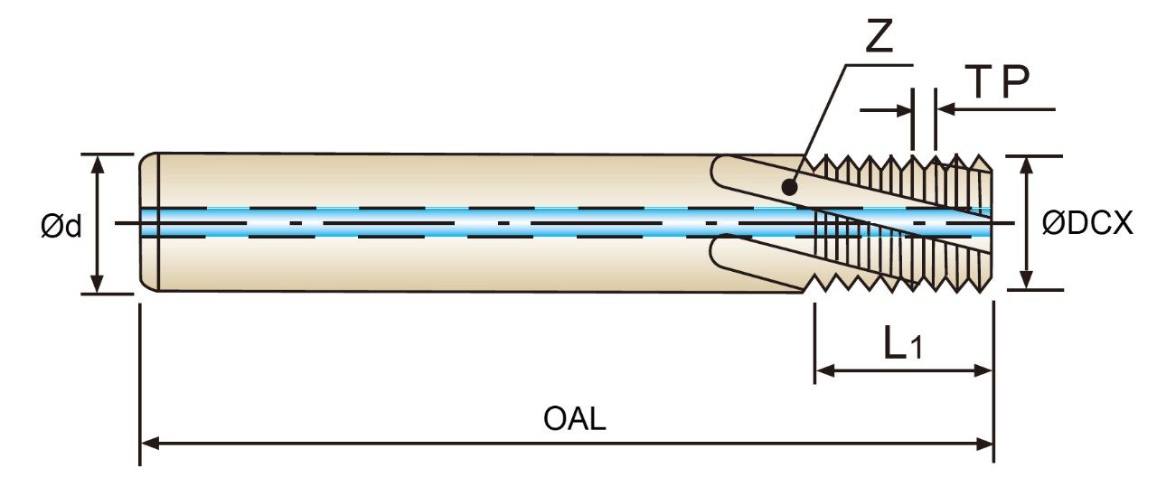

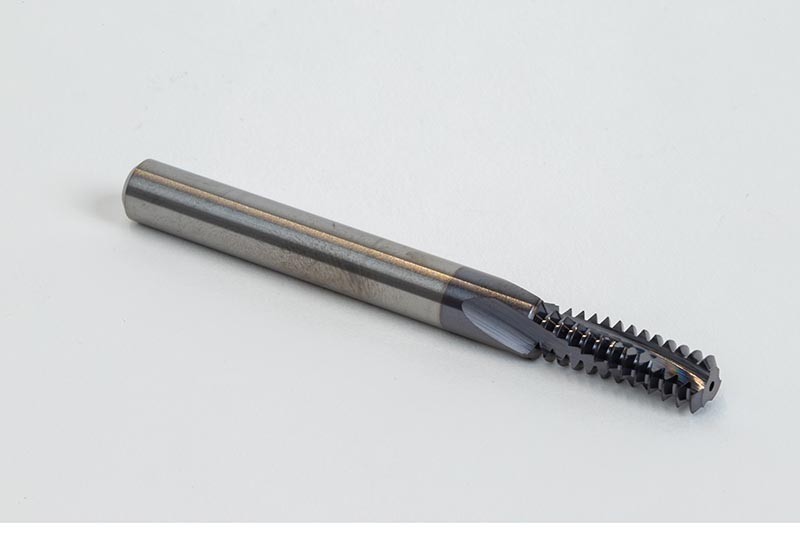

5/16"-18 UNC Parallel Internal Carbide Thread Mill, 1/4" Shank x 5/8" Thread Length, 3 Flute, TiAlN Coated, TSC
Part #: 03-0446
5/16"-18 INT TSC THD MILL
Price: 188.95 ( / unit)
132.97
5/16"-18 UNC Straight (Parallel) Internal Carbide Thread Mill, 1/4" Shank x 5/8" Thread Length, 3 Flute, TiAlN Coated, TSC
ISO Material Chart
Secondary Workpiece Material S - High Temp Alloys, K - Cast Iron, N - Aluminum, M - Stainless Steel
Material Carbide
Coating TiAlN
Shank Type Smooth
Thread Size 5/16"-18
[TPI] Threads per Inch 18 tpi
[ØDC] Cutting Diameter 0.235 in
[ØDMM] Shank Diameter 0.25 in
[L1] Thread Length 0.625 in
[OAL] Overall Length 2.5 in
[NOF] Number of Flutes 3
[FHA°] Helix Angle 15
Cutting Direction Right
Through Spindle Coolant Yes
