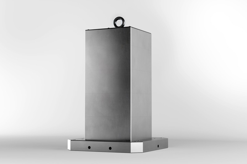

400mm Cast Iron Square Plain Tombstone
Part #: 05-0179
Tombstone Square, 400 Cast Iron
Price: 1499.95 ( / unit)
1424.97

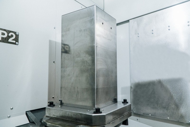

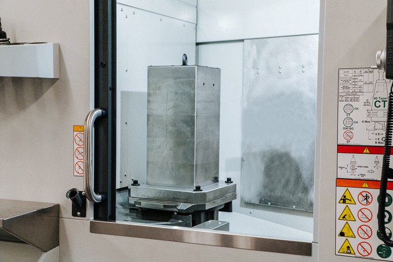

The Haas square tombstone has 4 sides that are perfect for mounting your existing work holding to and are designed for medium sized parts.
Everything For Mounting | Everything For Lifting
All Included

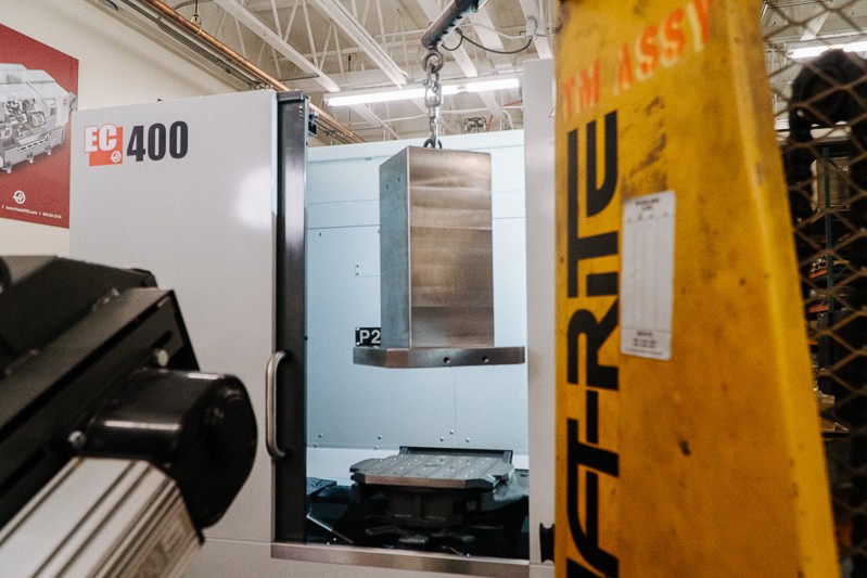

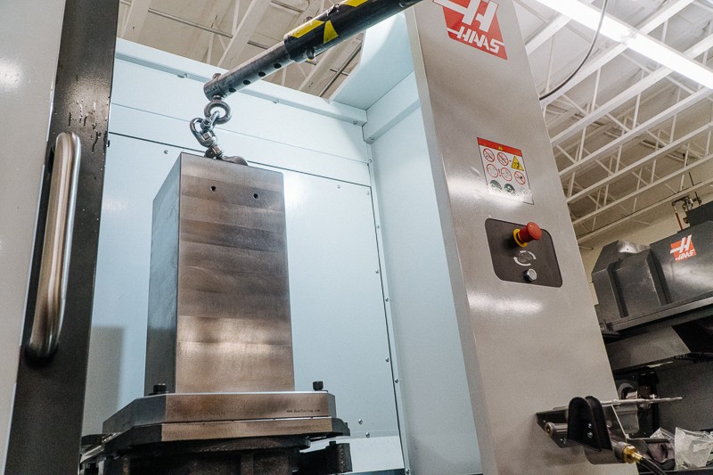

Haas Tombstones offers all of the hardware needed to lift and mount your tombstone. Including metric and inch mounting hardware for both styles of pallets.
Cast Iron Square Tombstone
  • Fits both metric & inch pallets
  • All mounting and lifting hardware is included
  • Chip and coolant cover included
  • Blank walls for any workholding application
CAST IRON
Weight: 220 lb \ 100 kg
SAME RIGIDITY, HALF THE WEIGHT OF OTHER TOMBSTONES
FEA Optimized For Maximum Rigidity & Less Weight
How Did We Save The Weight & Maintain Rigidity?
  • Gussetting on Interior walls
  • Top & Bottom Face Pocketing
  • Cautious Wall Thinning
  • Base Size Reduction
